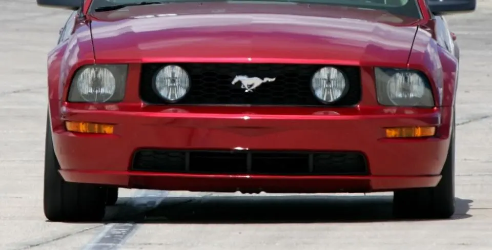

Incidentally, I love this picture. It's me exiting turn 17 at Sebring International Raceway a couple weeks ago. I'm sitting on 275/40-18 NT-05s at about 40psi hot at that point. I was surprised by how much the sidewalls deformed...

I'm not trying to make a point one way or the other, besides saying that tires almost act like mushy balloons when you pay attention to them. Treating them like rigid bodies misses A LOT of what tires actually do.
