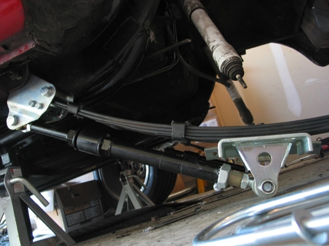

They are an absolute breeze to install, just an afternoon. Here's some installation pictures of mine going in:
http://www.edbert.net/axle.htm
I did them at the same time as a leaf spring, 9-inch, disc brake install and it took less than a day. Here's just one unobstructed shot of the bar:
Edit: No welding required but you'll need a hydraulic press to get the bushings replaced on your springs. I had a shop swap mine out.

rbohm said:
dont forget that the leaf springs also move in essentially a single plain. the traction masters use a rubber bushing like the leaf springs, so there is some bushing flex, about as much as the bushings in the leaf spring bushings.
Good point!
However, you're talking about one spring. They move independent of each other so the rear end needs to be able to articulate. A stable bar would bind if one side of the spring is compressed enough!
