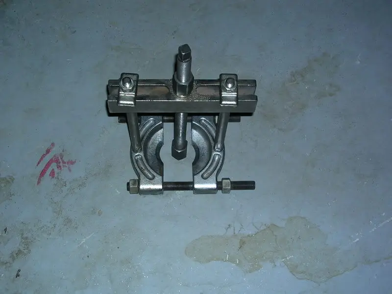

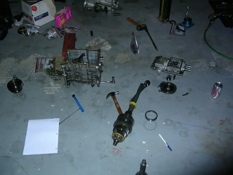

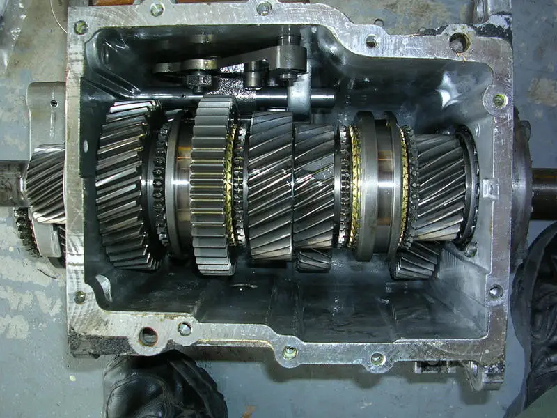

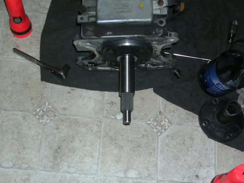

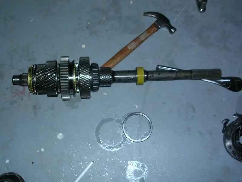

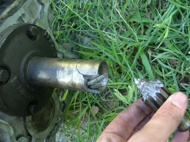

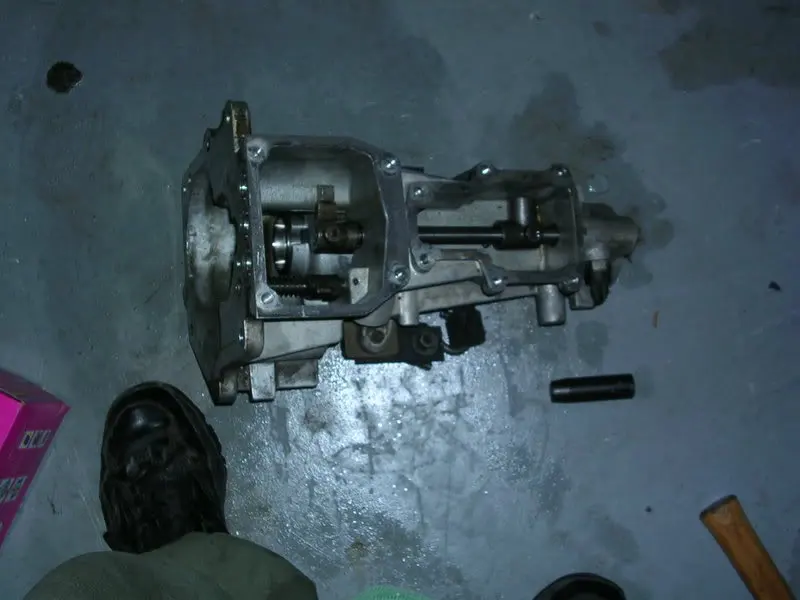

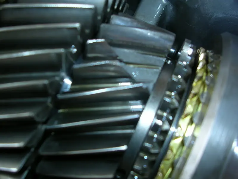

Since it has become a point of interest, I'm going to put some pictures up from the last time I fixed my transmission. I broke the factory 10 spline input shaft, and broke 2 teeth off of 3rd gear.
This is what the tailshaft looks like
Inside the transmission casing
This is the tailshaft housing that can be bored to accept a 31 spline input shaft
Replaced the retainer and upgraded to a 26 spline input shaft
The critical gear splitting tool for disassembling shafts
