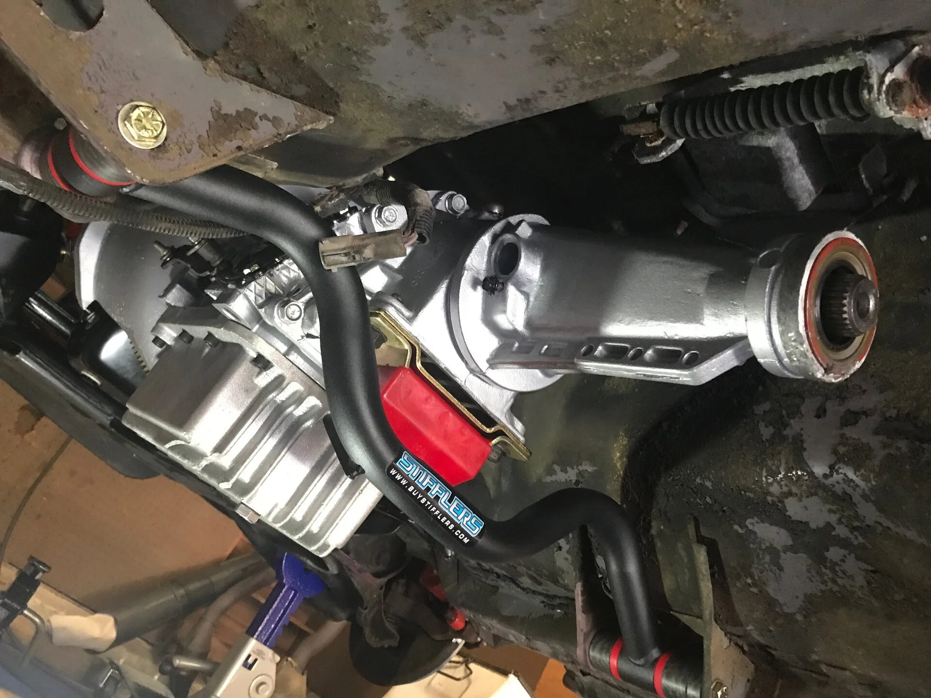

4. Does the crazy deep pan change anyones opinion on an of those previous questions? (see photo. Car is thick with undercoating. please ignore)

Let me give you my opinions and experience on a street driven tow truck, I know you're going to say but it's a truck not a race car (you are building a race car right? That's the only reason to put a c4 in a mustang nowadays) the first-time the trans (E4OD?) Was rebuilt the shop put duel coolers, the trans already had the deaper 4x4 pan so there was 3-4 quart extra capacity,
The average miles per rebuild for a Ford Tow truck trans at the time was less than 100k (most were in the 70k range.
The next rebuild on mine occurred about 150k later.
I believe in extra capacity and external cooling.
Now driving conditions and weather play a factor, like driving in freezing conditions with external cooler may keep the trans fluid from reaching operating temp, but this is a race car right?
There are a few other things that come into play like converter slippage and the like.
