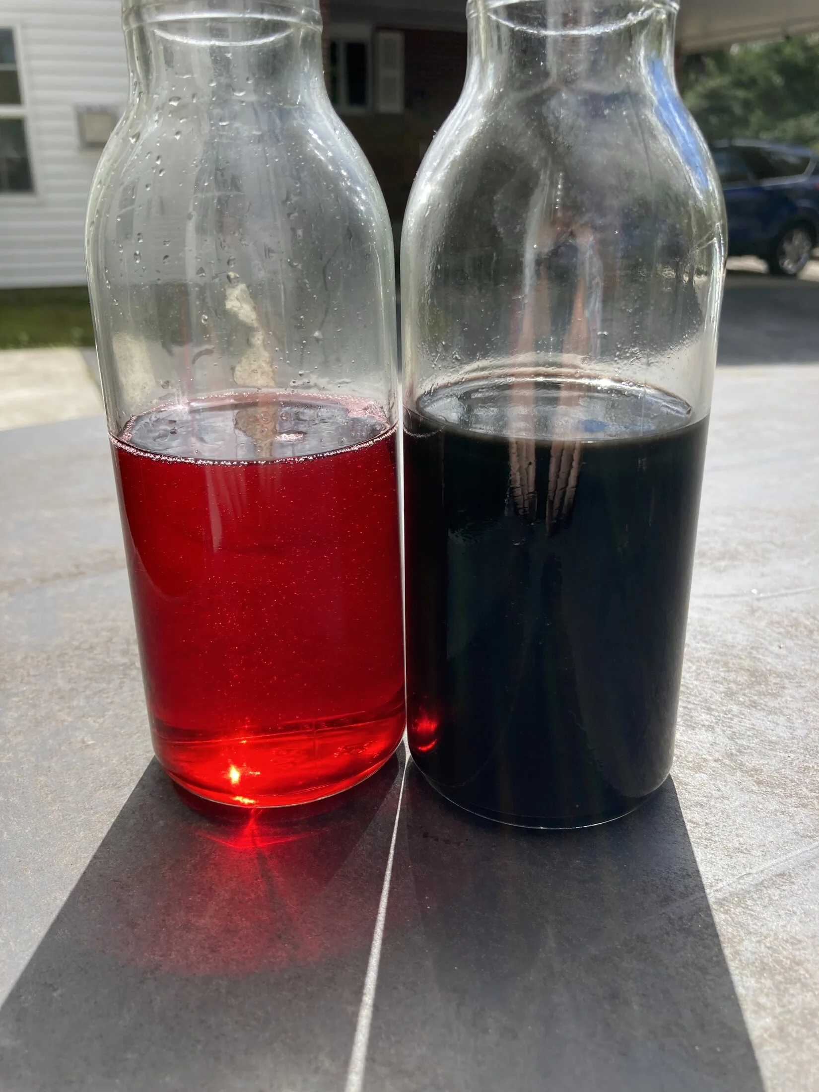

My wife’s 2013 2.0 Ecoboost Escape owners manual says the first transmission fluid change is scheduled at 150,000 miles. I just did a triple drain and refill running through 12 qts of new LV fluid. Her odometer is at 26,850. Look at this fluid comparison between old and new. The old stuff is jet black. They should recommend it sooner than 150k in my opinion.

I see trans fluid like this all the time.
GM has a bulletin for some of the Silverado transmissions to perform a fluid exchange for a transmission shudder. And they have a trans cooler.
It happens as soon as 25K miles. It fixes the concern and we get paid fairly well to do it. 24 qtrs of fluid used in the exchange process.
