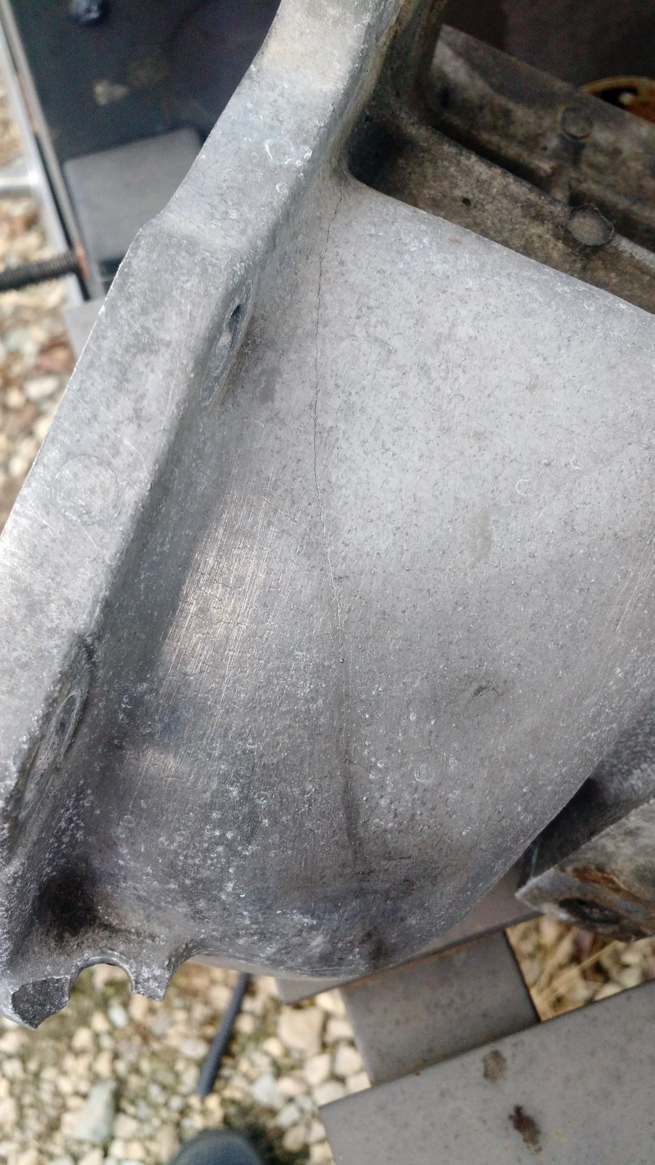

B Bluestang93 New Member Aug 16, 2016 6 0 1 Aug 17, 2016 #1 Aug 17, 2016 #1 My 93 hatch 5.0 5 speed keeps cracking tailhouseings I've been through three now and I just cant figure out why Attachments IMG_20160808_170411265.webp 470.8 KB · Views: 181
Mustang5L5 That is…until I whipped out my Bissell Mod Dude Feb 18, 2001 43,349 18,085 224 Massachusetts Aug 17, 2016 #2 Aug 17, 2016 #2 Driveshaft out of balance? Sent from my big ass iPhone 6 using Tapatalk Reactions: Bluestang93
B Bluestang93 New Member Aug 16, 2016 6 0 1 Aug 17, 2016 #3 Aug 17, 2016 #3 I'm not sure but I think so because there is a strong vibration at about 65-80 at any other speed it doesn't do that would that cause it to crack
General karthief wonder how much it would cost to ship you a pair Mod Dude Aug 25, 2016 28,114 10,733 213 polk county florida Aug 26, 2016 #4 Aug 26, 2016 #4 Jumping in here late but did you figuare it out? If not is the rear trans seal wasted or deformed? Is the driveshaft bottoming out or maybe not in far enough?
