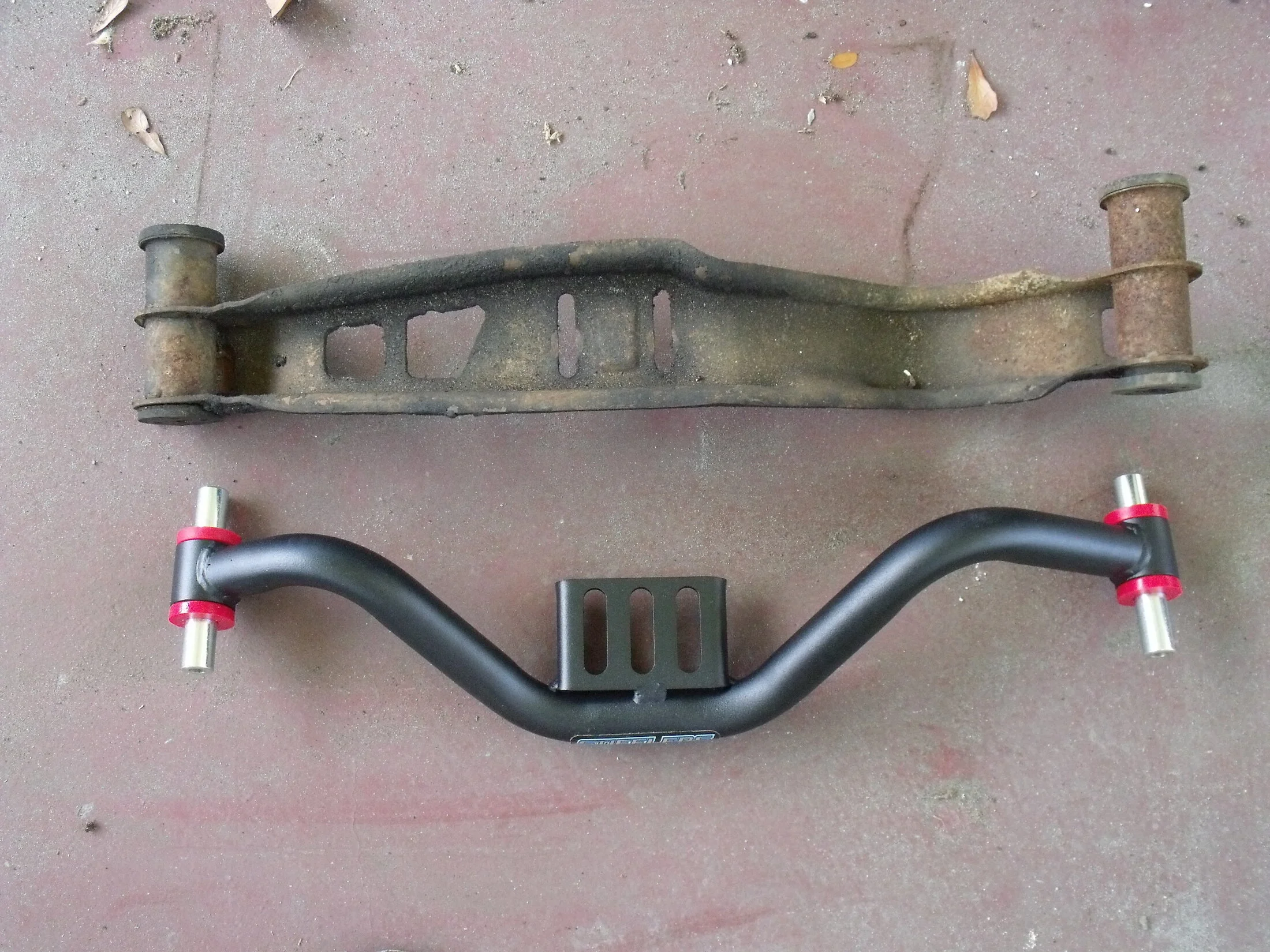

I " think" the stock one works with a new transmission mount... I could not use mine as it was a for a single exhaust..
The stiffler one fits really nice.. Its small and up out of the way...

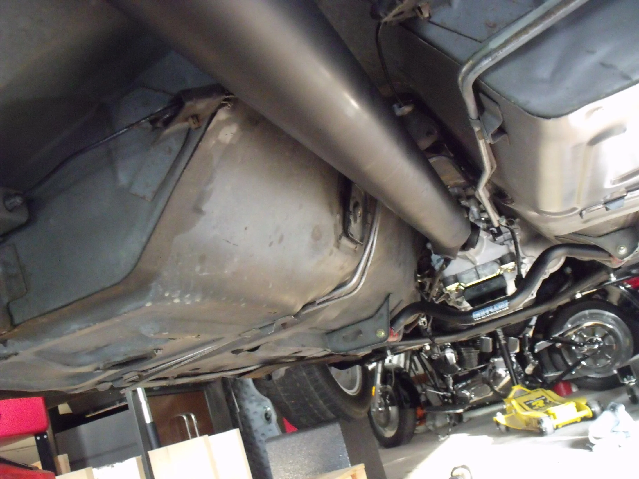

I did not have my exhaust on, so I bolted up one side, then I swung it up and bolted on the other side and the bolt holes for the transmission lined right up... Kinda like things are supposed to work....
There is a " kit " sold for this which is nothing more that two very thick plastic bushings that lift the transmission up a bit for driveline alignment... I have one installed on my car but from what I can see it might vary from car to car.... Found a decent pic of mine installed with a TKX...
