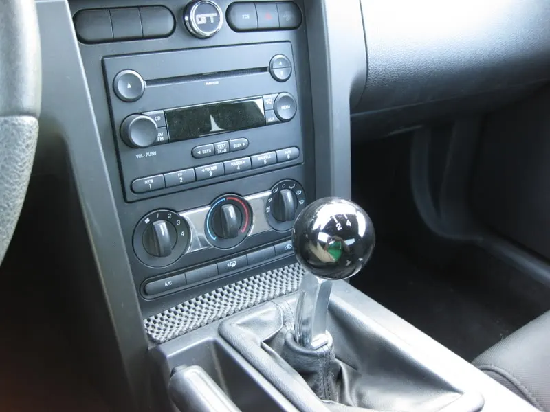

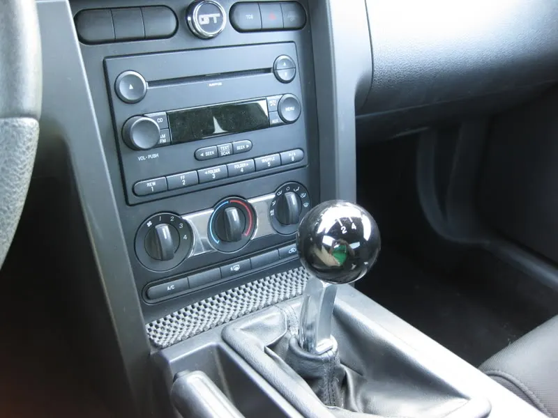

Tri Ax installed with optional arm and hurst black ball. All the style with a ton of function. :nice:
