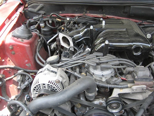

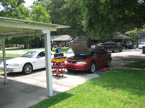

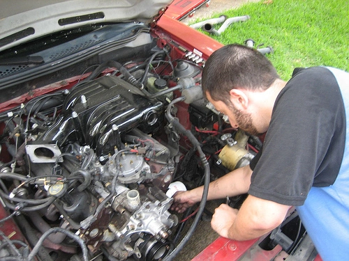

Started on the trickflow hci, today was teardown, we got down to the heads. Even loosened half the head bolts, tomorrow that comes out and we clean everything up and begin the install. Took us about 6 hours taking our sweet time with a 1 hour break for dinner to tear down almost to the block. We took our time and didnt stress ourselves, labeled alot of baggies with bolts, kept our tools in fairly neat order. We only lost 1 thing!! and that was the marker, and we found it...haha anyways heres some pics!
My man slave taking apart the exhaust (stanger007)

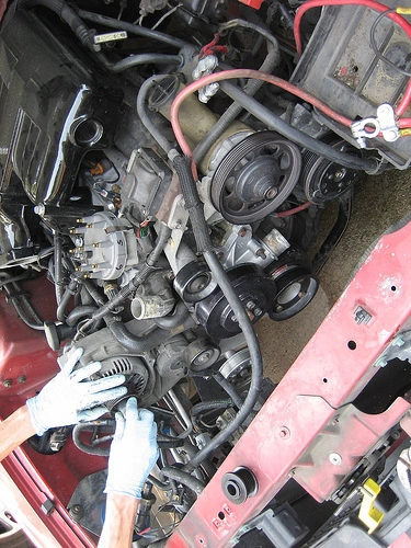

Trying to put an overdrive alt pulley on...socket wont fit so cant install it

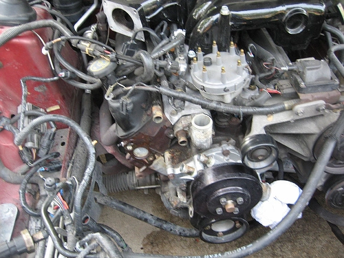

Cai and throttlebody removed

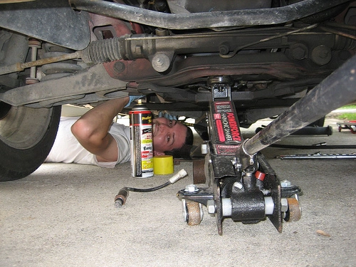

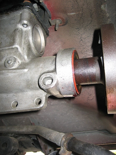

Tailshaft of T5, it dripped a couple drops of oil, but the front was jacked up, is that normal when tilted?

Alt pully bracket gone
Me removing ground strap
both access brackets gone, water pump removed

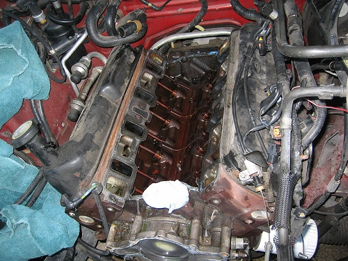

Bye bye upper intake

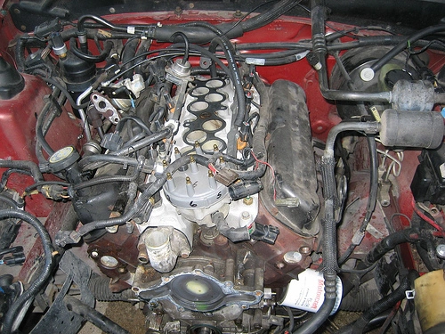

Injectors, lower intake removed

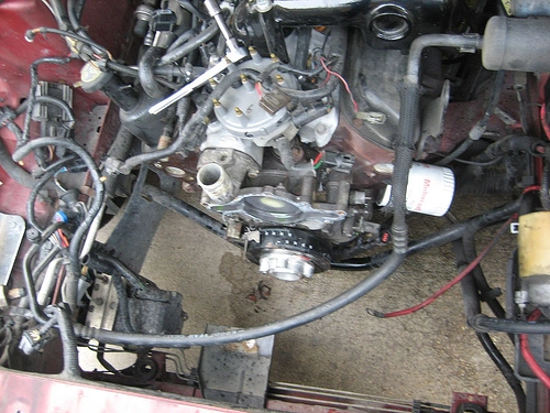

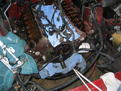

Valve covers, timing chain removed, some header bolts removed, head bolts loosened. I got tired and my back was hurtin so we stopped here for the day.
With the passenger accessories and intake removed the front sits a good 2 inches higher, the powersteering and a/c are still in there. And we havent even removed heads...no pics of that but i will take one tomorrow
