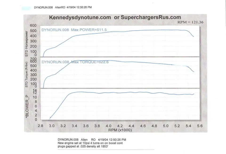

If I'm understanding you, you were running your own car on the dyno?:eek: I've dynoed alot and with different shops, NEVER have I ever run the car on the dyno myself. Find a different place. I have the HP T60 street kit, and with plain old GT40 heads and a Cobra intake it made pretty good numbers. Maybe you don't have somthing exactly right? Here's my sheet. PM me if you need some help.
