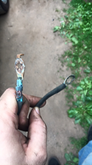

if someones doesnt think a ground matters their dumb lol it's definitely important, just look at the picture of my engine to frame ground just that wire was preventing my car from starting and when i got it to start before changing it my oil pressure and battery gauge where all messed up. put a new one in and bam runs as good as it did before

That'll do it.
