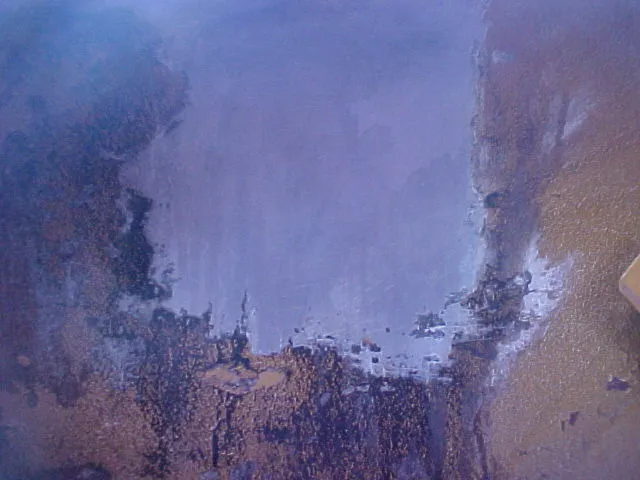

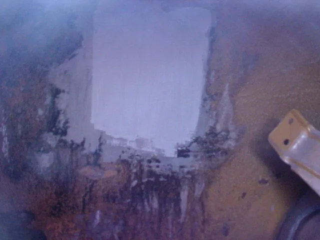

I decided to get rid of most of the rust in my trunk since I just got paid:D. I bought some of eastwoods rust encapsulator and some rust dissolvent. I used a non scratching surface steel wool pad to clean most of the spackel or some wierd bondo/paint like crap that covers the inside of the rear fenders inside the trunk. I cleaned a small area and applied the rust encapsulator just to see how this stuff would work out. The pics below show the bare metal(and surrounding crappy paint stuff with rust in some areas) and the other shows the encapsulator paint. I'll post more pics when im done :nice:

Both pics are of bare metal. BTW you don't have to go to bare metal with the Rust Encapsulator, just remove the loose rust and go at it. Of course you still want to get that tar looking crap off of there so it is actually on the metal or rust.
the first picture in the attachments show the silver encapsulator paint that I used, even though it only covers a small area of the bare metal, im gonna finish it tomorrow( or at least most of it). My parents digital camera sucks, I'll use a light to help illuminate the trunk next time. I decided to use an encapsulator because I wanted to know that I have removed all of the rust and when I get enough money im gonna get the car stripped down and have it sand blasted. But that wont be for another 4 years:nonono: so this is gonna have to do for now.
