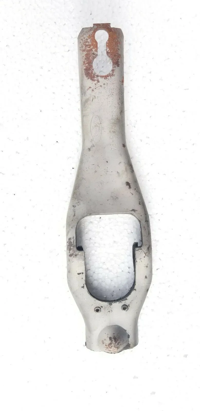

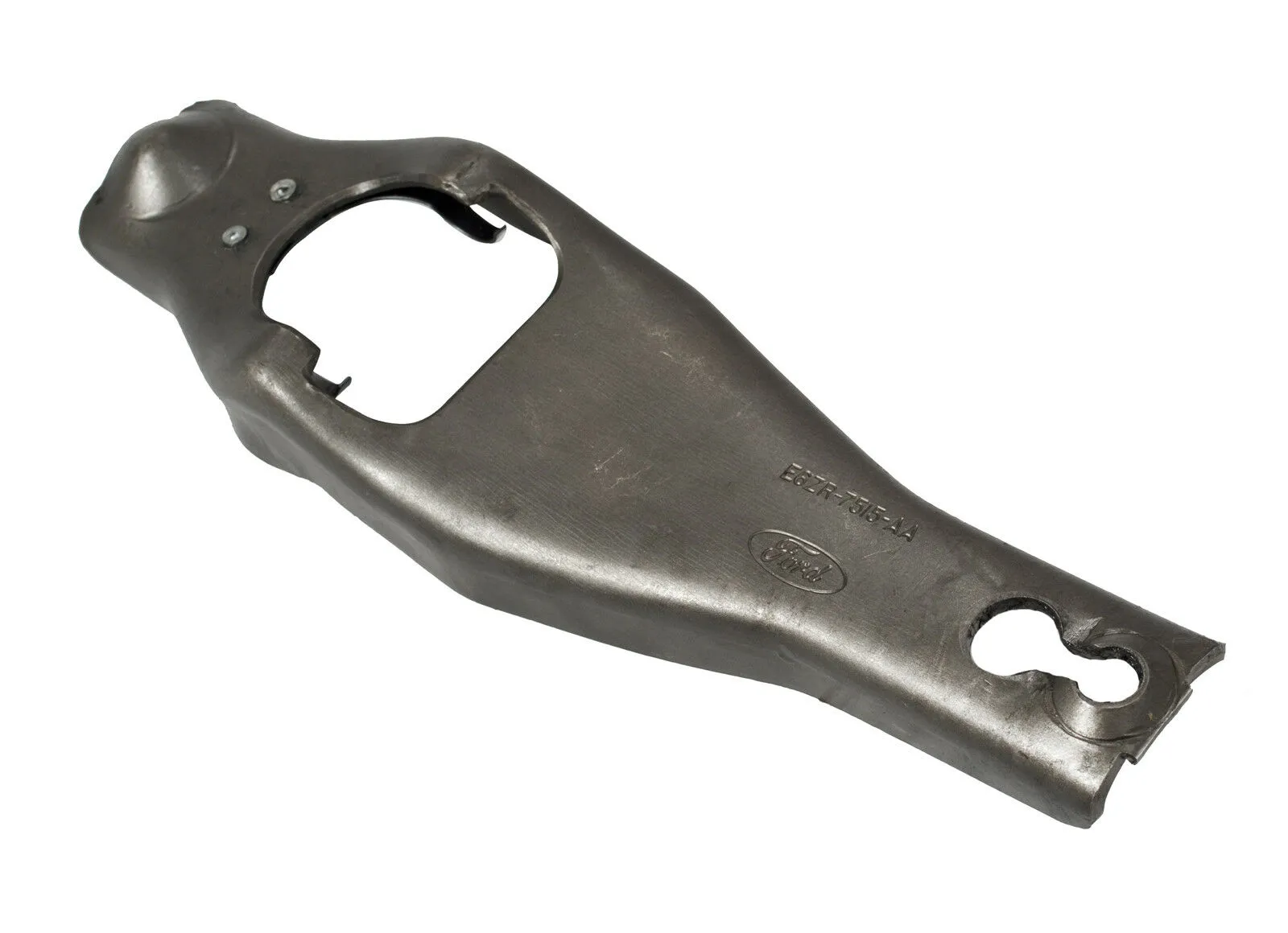

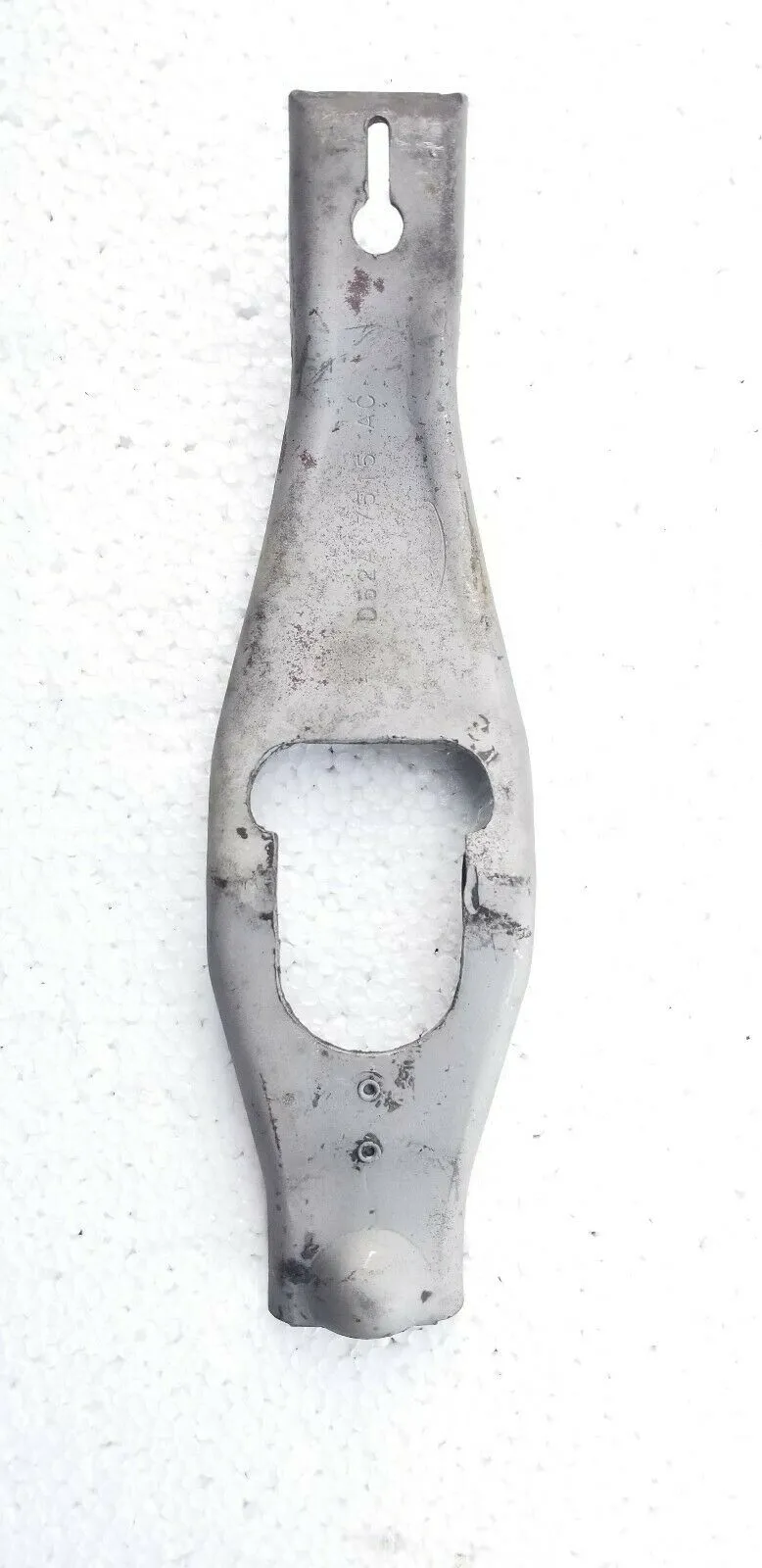

What does the stock76 clutch fork look like? will 79-up fork work in 75-78 bell?
Well, it may be a week or more till I can show you a photo. And, I'm hoping for some nice weather in MN so I can get out fishing. So I don't know if a 79 will work. I was thinking the same route with a T5 but am very happy that there is a clutch out there.
Although as long as I have to get the flywheel done anyway; the original results of this thread would be nice to know as the clutch kits on carid for the 79 are a lot cheaper. I don't care as long as I can get it on the road with a reliable clutch.
Reactions: 2Blue2
I don't think the 79 clutch fork will work with the II's bell housing, but I could be wrong. If memory serves, the later one has a bit of an angle to it from the pivot point and throw out bearing area to the clutch cable connection point whereas the II fork is fairly flat. It's been a LONG time since I've had them side by side, so I could be way off base, but I'm sure that they are indeed different.

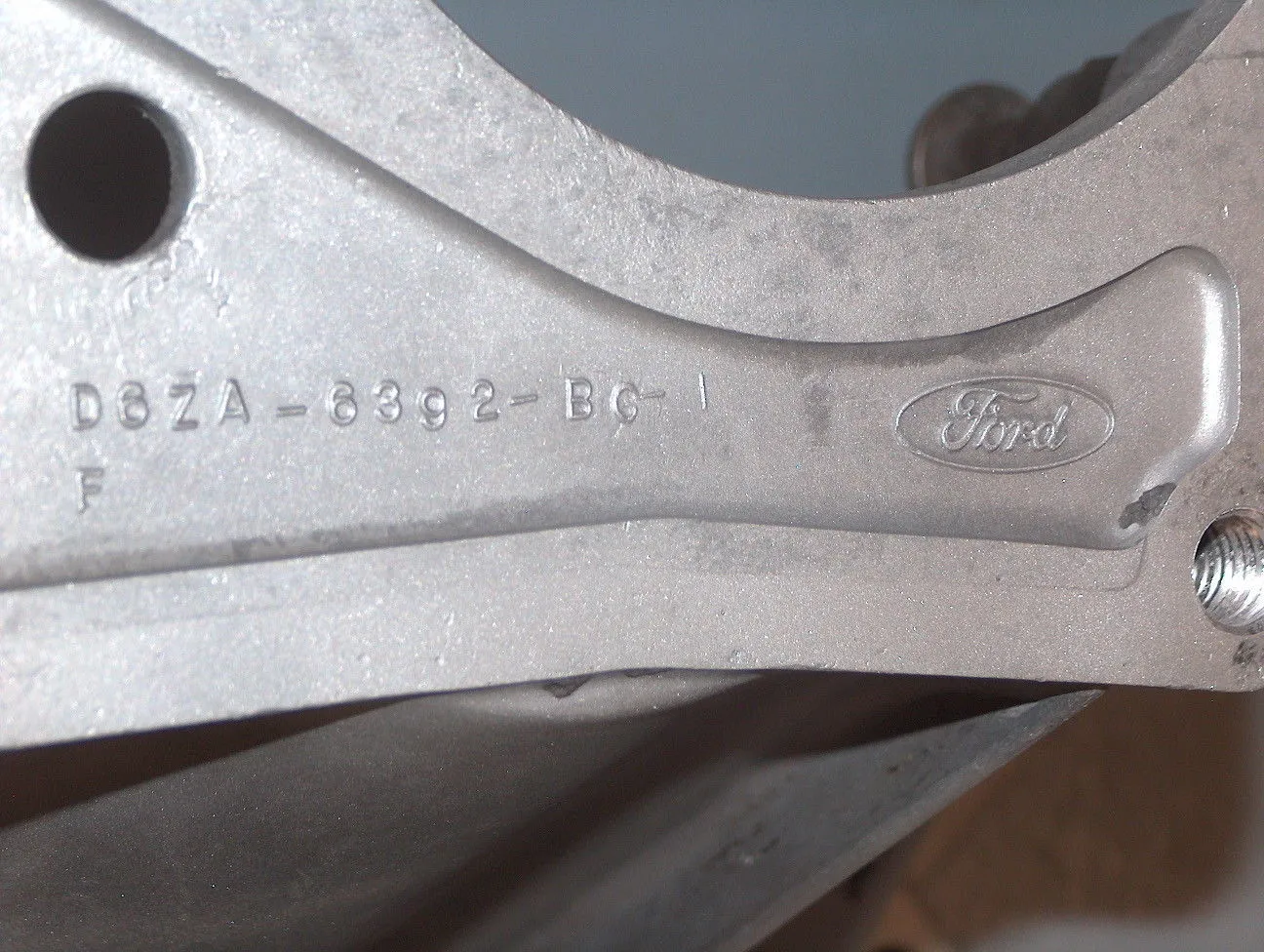

1976, 1979, 1988
Looks like the 76 doesn't have a z in the part number might not e a mustang ii

its not uncommon with yrs of abuse for the fork to bend forward over time..
i have heard that the clutch your using has a softer feel to it..
this is my clutch fork in good working shape.

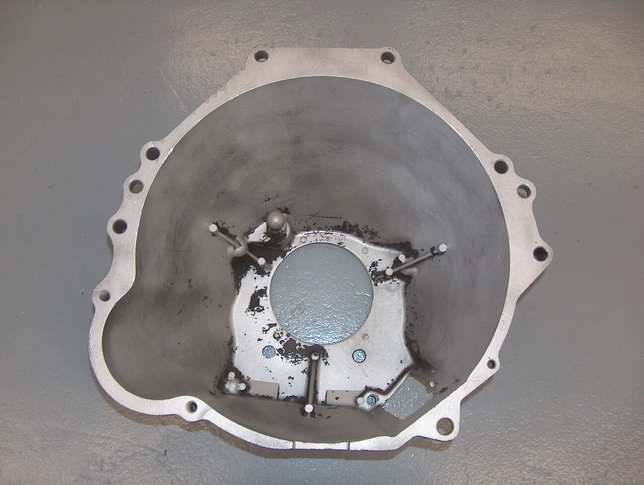

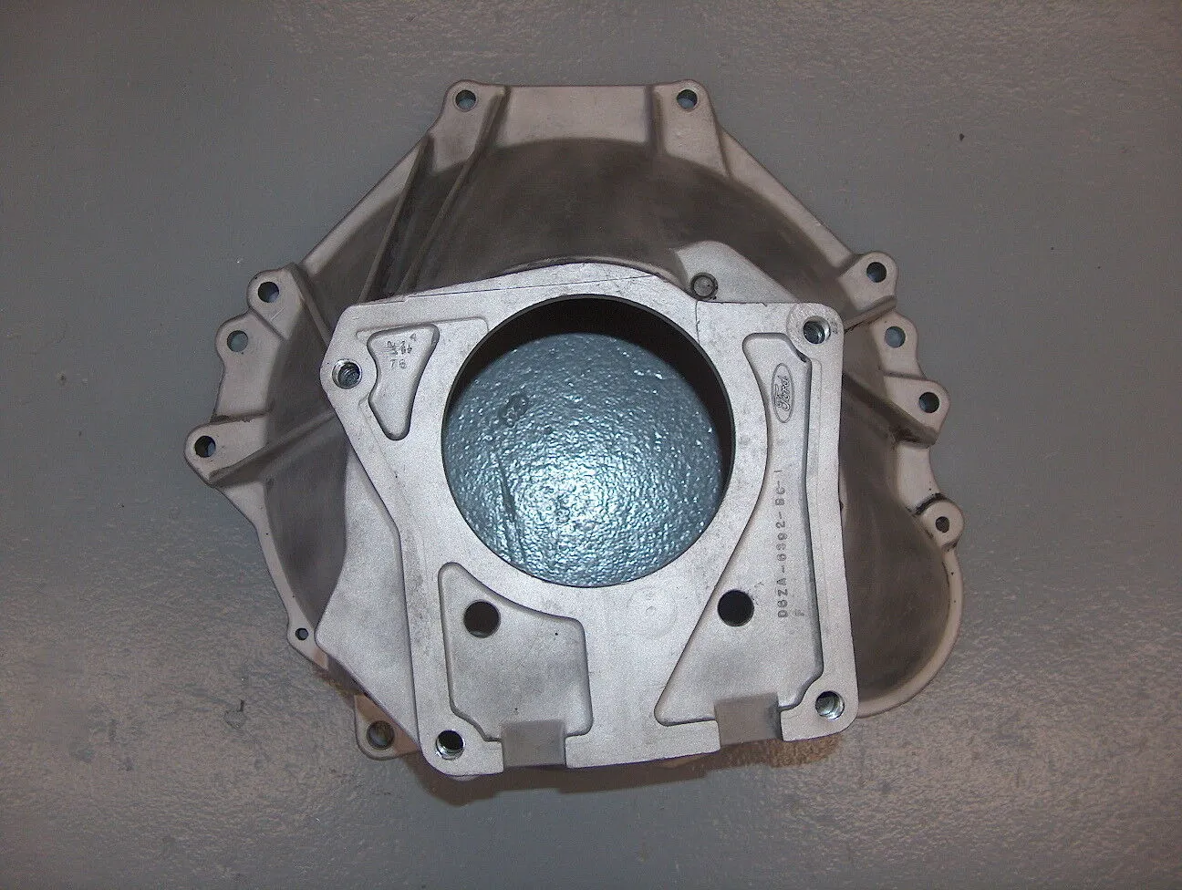

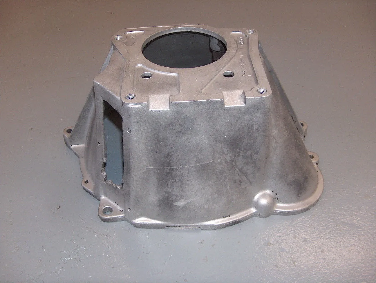

Bellhousing; ( pictures from eBay with fork hole cut bigger for more travel.)
