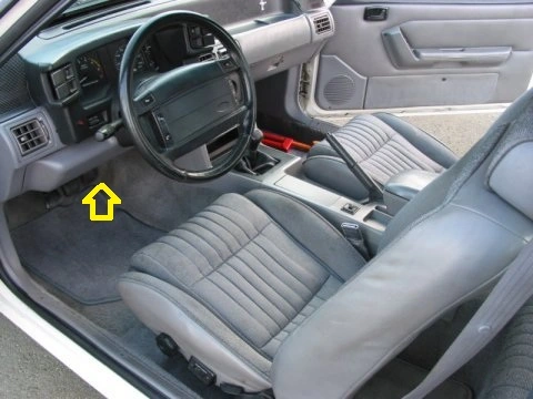

I think I may get one anyway just so I can see what's happening in the engine, because it's definitely not running right and spark plugs and O2 sensors didn't fix anything. I also can't find the OBD plugin or fusebox. They seem to be near the firewall or something. I guess there's a reason it was listed cheap
Diagnostic connector
Fuse box
Hope that helps man

RaggedGT said:
Hope that helps man
Okay, thanks for the diag port, never used one on a fox, but the fusebox has been relocated somewhere inside the dash. It's not in the normal spot. Would it be safe to start it up in the current condition of backfiring and running poorly to get a reading on the port?
