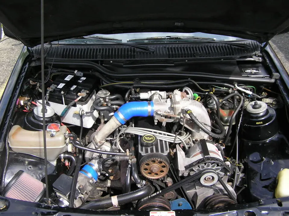

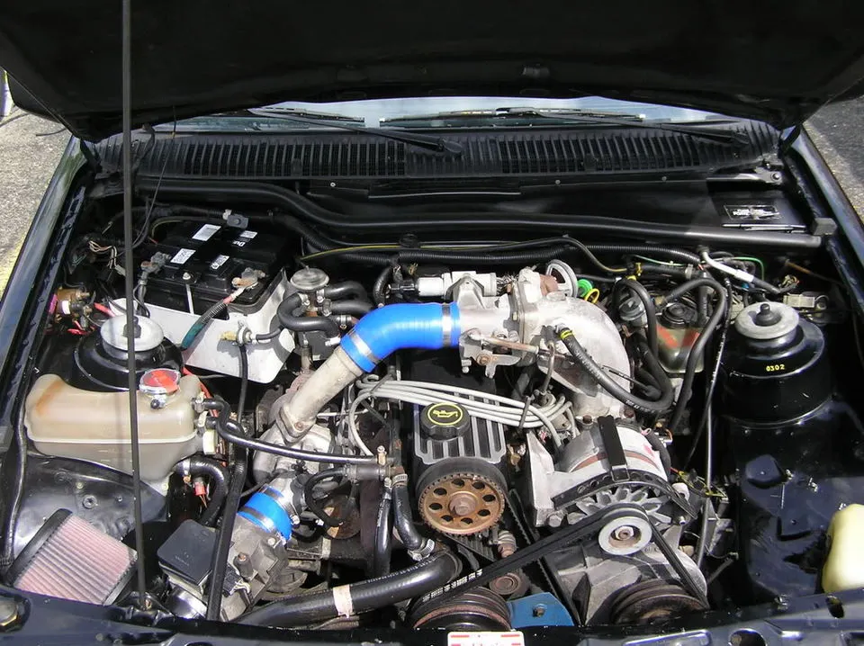

Here's a coupe pics of mine:
Before the ghetto intercooler:

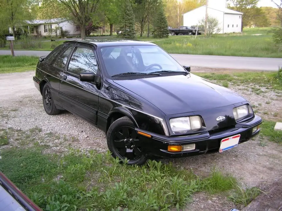

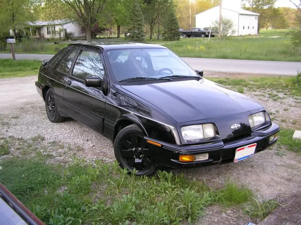

I posted some pics below. The car is a huge POS, but that adds to the sleeper effect. It is so very cheap and I don't have much money in it. In fact, the most expensive single part were the nitto drag radials at 150$ each.

A picture of the pile: http://img504.imageshack.us/img504/5770/p1010165xg6.jpg
I'm a fan of sleepers, looks good to me!
