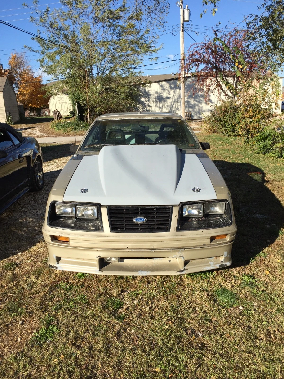

heres a pic of the car.
i had an 86 lx car before this and a 91 coupe as well.
