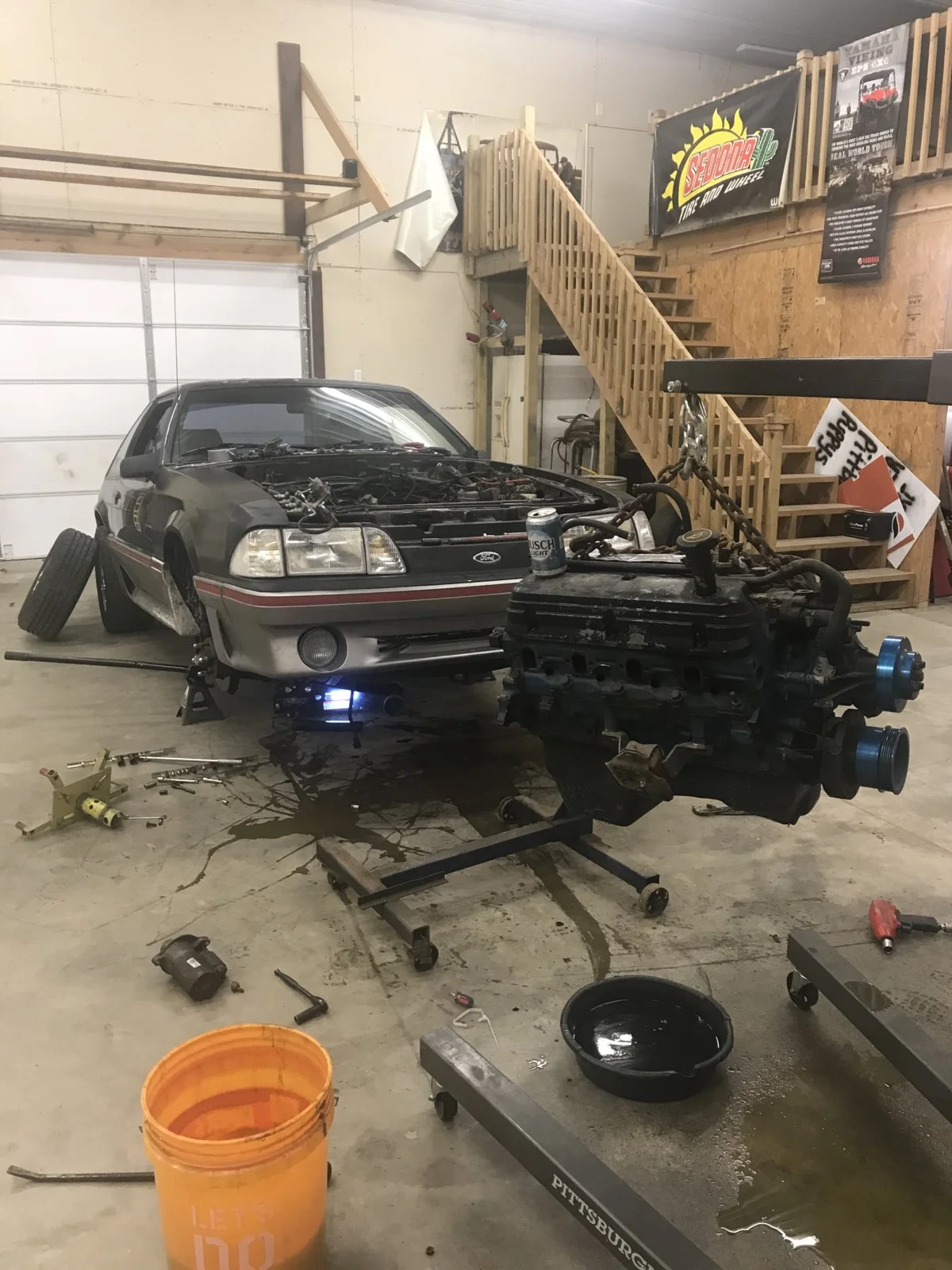

Won’t post a pic what the heck

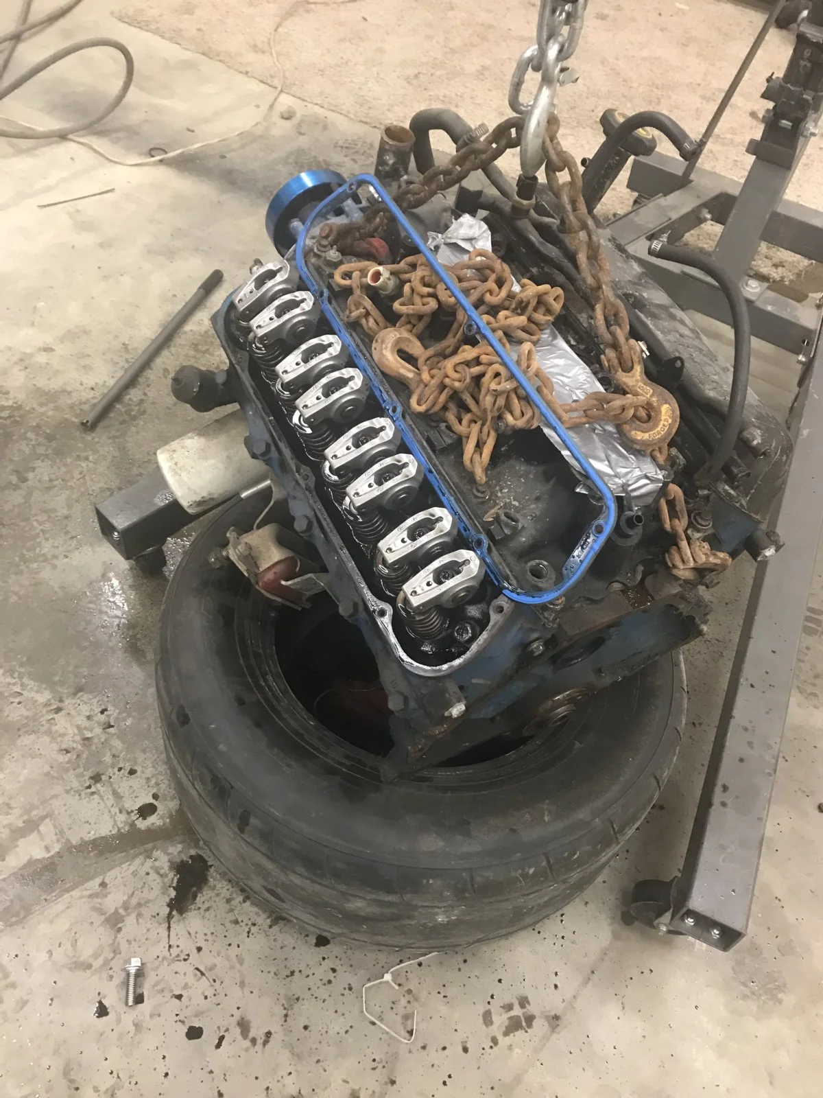

im gonna get it on a stand tonight and take it apart so maybe i will see some casting numbers or something. i didnt see the 3 bars like my last ones had on them, but the exhaust ports dont look all choked down like an e7 head. unless someone already took a bur bit to these.
I had a set of e7 heads that were ported and had 1.60 intake 2.02 exhaust valves added. Mine ran pretty dang good. There was a guy that used to build them in the 90s.
