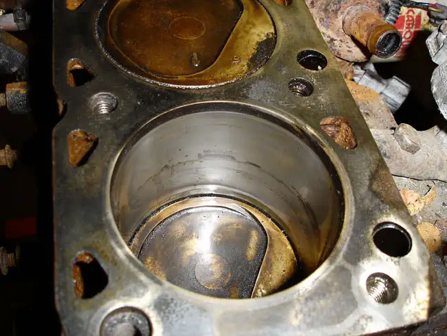

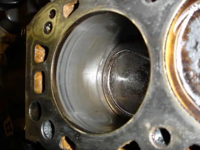

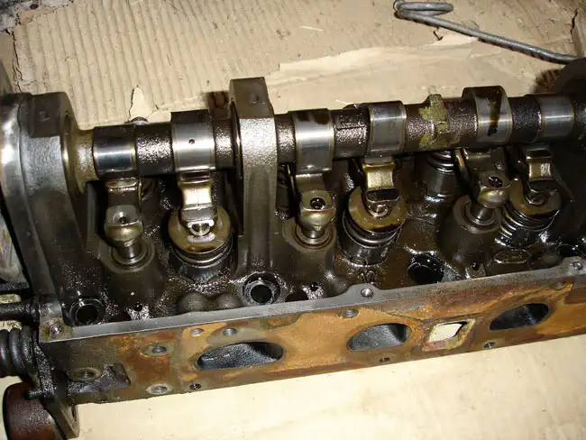

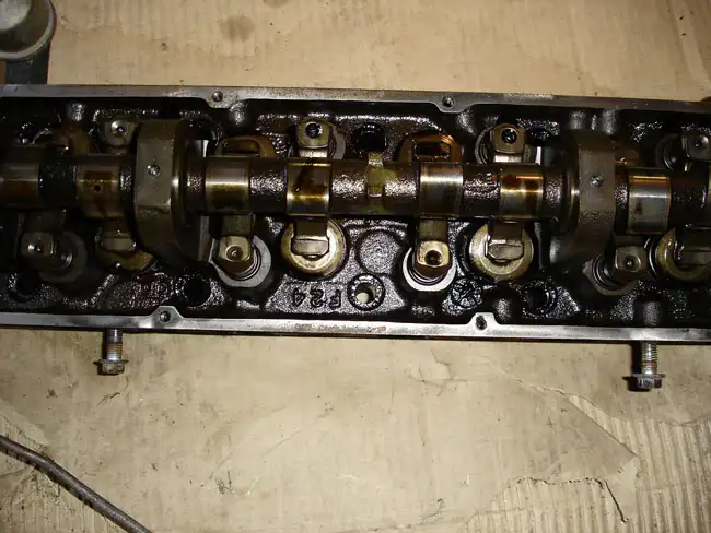

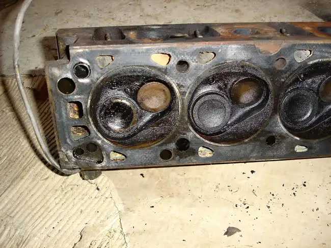

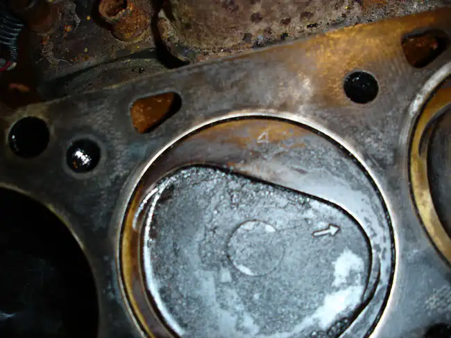

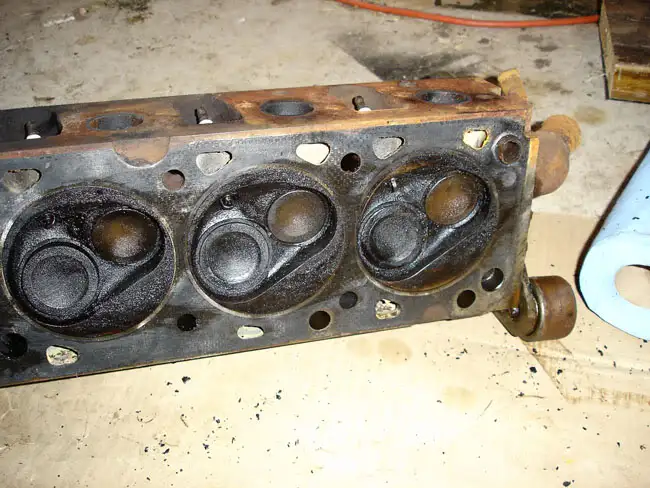

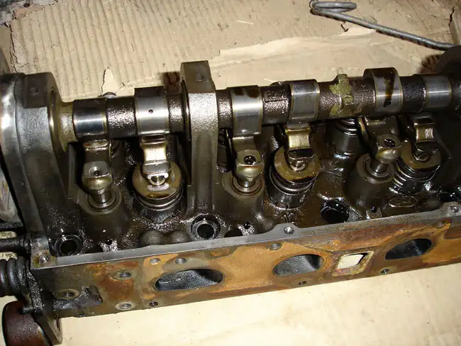

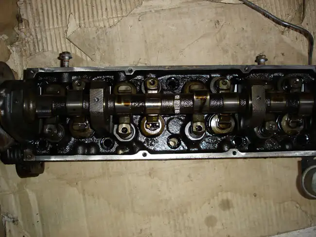

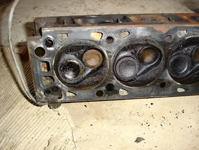

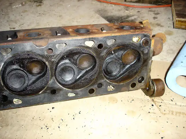

Alright, so i finally took apart my turbo motor.. atleast the top end of it anyway and It actually looks really good but I havent worked on one of these before so I want some opinions on what i have..... and now.. the pics....

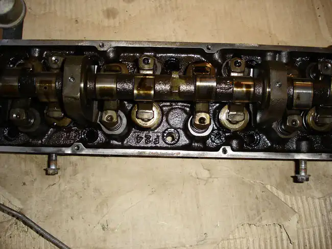

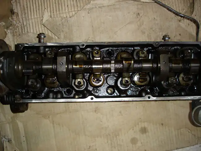

First off.. The head.. there is ZERO oil sludge in this head. which really suprises me. Im guessing its been rebuilt recently.
Chambers have a little carbon, but not too bad.

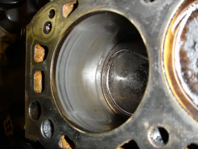

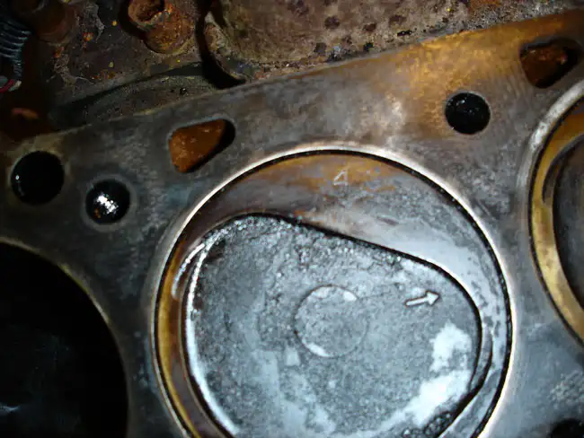

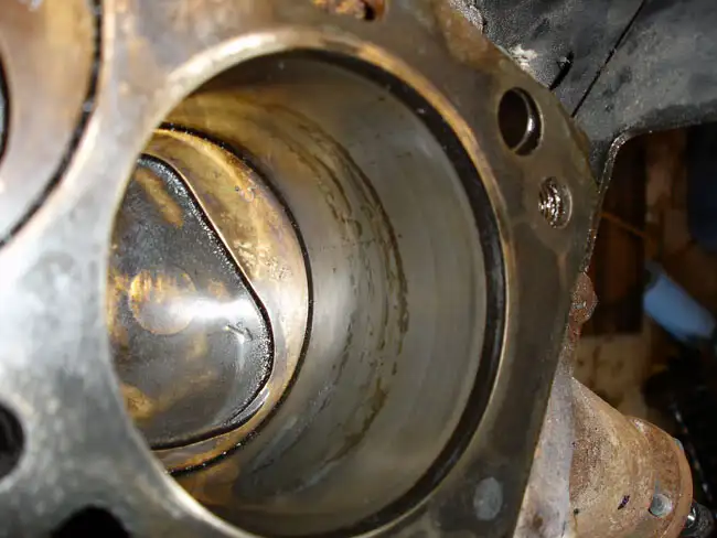

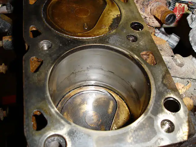

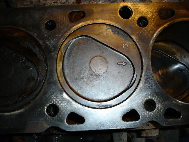

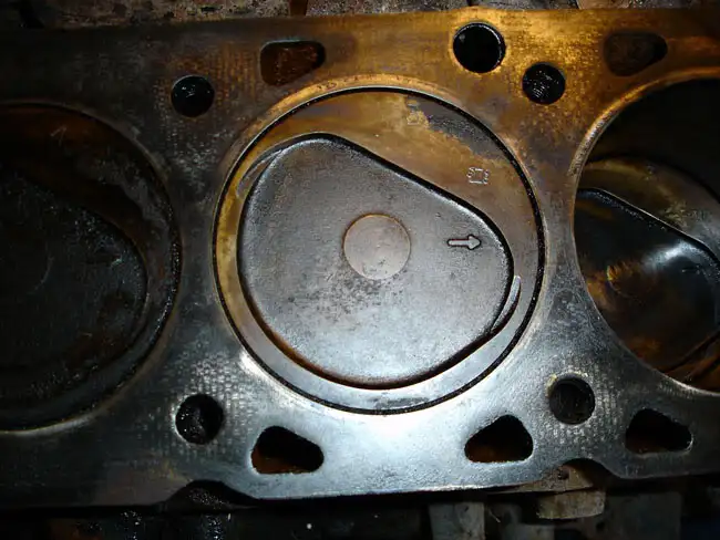

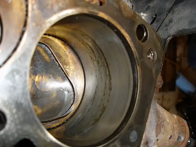

Now the cyl i have some questions about. Looks like i have some staining in one cyl, and the Back two are Dirtier then front two. What i found strange is that the front 2 pistons have a "3" stamped in them and the back 2 have a "4" stamped in them. is this normal? the pistons themselves appear to be in good shape and the cyl walls are smooth to the touch with no ridges or scoring.
Well, what do you guys think? I am guessing i can just re ring it, Hone the cyl walls and go. Any input is welcomed.

Looks like that engine was sitting for awhile.
Dan'l, what are you talking about? You can't see anything under all that carbon/oil grime. Probably just something with that.
Anyway, besides what you mentioned, check the valve guides. My engine I'm rebuilding had about 145K on it and some of the valve guides were way out. Easy way to check the play in them is to take the spring off, slide the valve out just enough where you can grab the valve face around the outside and wiggle it.
Stinger said:
Put it back together and run it....
Does your n/a motor have sludge in it? I've never taken apart a 2.3 that was any dirtier than what I'm seeing in these pics.
Stinger, ive not taken apart the N/A motor yet, I gotta drive it though the winter. Other motors i have taken apart though have always had sludge in them so i guess thats what i was used to. Some of what you may be seeing is WD40 making it look wet. I used some to try to clean things off a little. I am going to check the bearings and rings and will likely just throw some rings and bearings in it and put it back together.
Red, The motor has been sitting for at least 2 years in my garage, Who knows how long it was sitting someplace else. I have a feeling it hasnt ran in a long time. I havent taken the pan off yet so i dont know what i will find on the bottom end but hopfully that will happen in the next few days. The head has "RBLT OK" stamped on the back of it in ink and the gaskets looked pretty new too so i am guessing that the valve seals are good but i will check it out when i change cams.
Dan, i rotated the cam around and looked at the seats and the looked pretty good but i will check everything again before its put back together.
Anyone know whats up with the numbers on the pistons?

It's easiest to just unbolt the brackets for the accessories from your n/a engine like the power steering pump and a/c (if you keep it) and just strap them outta the way next to your inner fenders. Pull the engine out, swap the front end stuff like the waterpump and thermostat you know are working well, doesn't matter on the timing gears you choose imo, drop the turbo engine in and bolt that stuff back on.
I'd do what Stinger said. I wouldn't re-ring it or do anything to the bottom other than replace the front and rear seals. I'd have the head dipped, put new valve seals on it, do you're flow work on it. Get the engine back together and get it in.

Im just curious why people recommend this course of action. I have the motor out, and apart. a rebuild kit doesnt cost that much Why not just do it? I plan on keeping this car around a while so i want to do it right the first time. The problem i have is i have NO idea how much milage is on this motor. Could be 50k , could be 500k i just dont know, And i would hate to find out it has insane blowby the first time i fire it up in the car. Other then the money aspect, why SHOULDNT i rebuild it? Im not gonna do any machine work other then a hone, and i havent decided what to do with the head yet. I currently plan to rering with Std's and go. I have a rebuild manual, stingers wiring instructions, and a mechanic friend who can help me if i need it. I just fear that i will put it in stock and end up with a smoking underpowered waste of time. Im not totally discounting your advice, i am just curious why you suggest it.
Dr.
I understand you doctor - I'd just go real light w/ the hone, make sure you only knock off the glaze and be done w/ it.
Seems so many engine rebuilds burn more oil than they did prior. YOU ARE NOT BORING IT PEOPLE! If you've got one that show's everythings healthy I'd keep it like that for as long as possible.
On the other hand, when I did the LX block I honed it lightly and was my regular really major anal self about wiping down the cylinder walls, putting it back together carefully and it doesn't seem to burn a drop. I'm sure you'll do likewise.
Well, I'm more or less complete redoing the engine I'm building (honed, new moly rings, had crank journals polished, etc). The engine had 145K on it and the endgap on the stock rings was out a bit so I figured they were due up for replacement anyway. The block had some kinda deep scratches in some of the cylinder walls but the pistons all checked out ok, so I dunno. I'm expecting to have some blowby but hopefully nothing major and hopefully it'll run pretty good. If not, well...I don't have a ton of money in the engine so it's not a huge loss.
At any rate it's gotta be better than the engine that's in the car now, which is spewing oil from every orifice.
yeah, my friend has done Many engines, he has a Mic set. so i plan to check the clearances on everything before it goes back together. And yes, i was planning only a light hone. I head is whats gonna cost money and i havent decided what do to with it yet, but i probably should do a rebuild with atleast new seals on it. I wish i could port it but i have no skills in that area and would likely just screw it up badly, Im a broadcaster, not a machinist so ill leave that part alone. I need to send my injectors off and have them cleaned, but other then that the motor is going back mostly stock.

If you are gonna leave the head alone, take it to a machine shop and have it dipped, it will look like new. Do a valve job yourself, put in new valve seals, throw the lifters/cam/rockers back in and wallah! New head! It'll be ready for you when you are ready for it.
