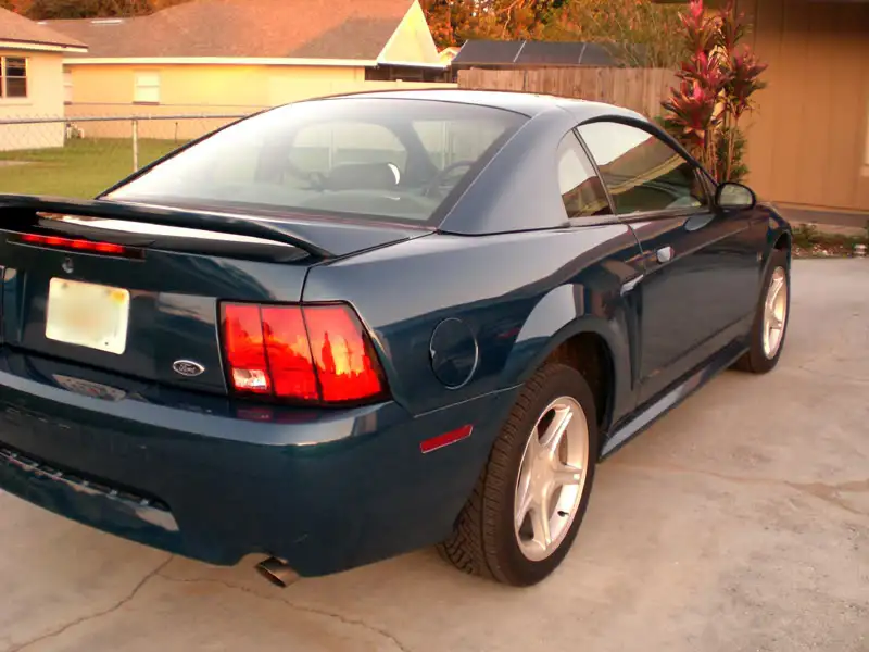

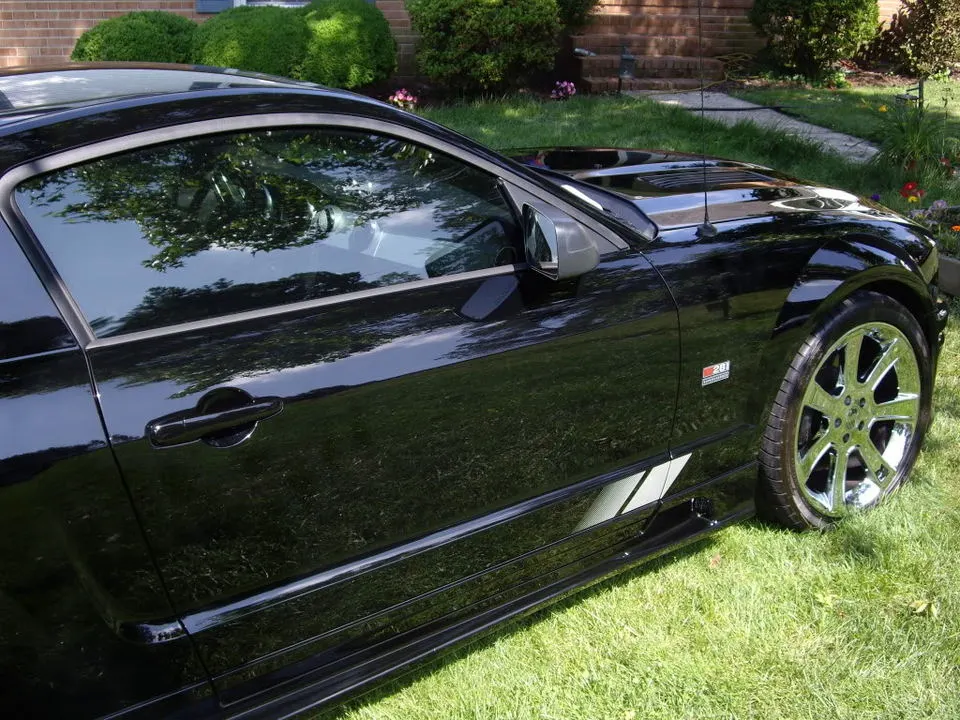

It aint that bad. I regularly detail my car, and I don't have a garage so it's done outside. I use a bit expensive carnauba wax but it lasts around 5 weeks, and it's very easy to apply and buff off, unlike over the counter stuff.
Here is my car after a wash and 1 coat of wax.
Your car looks GREAT!!!!! very nice!

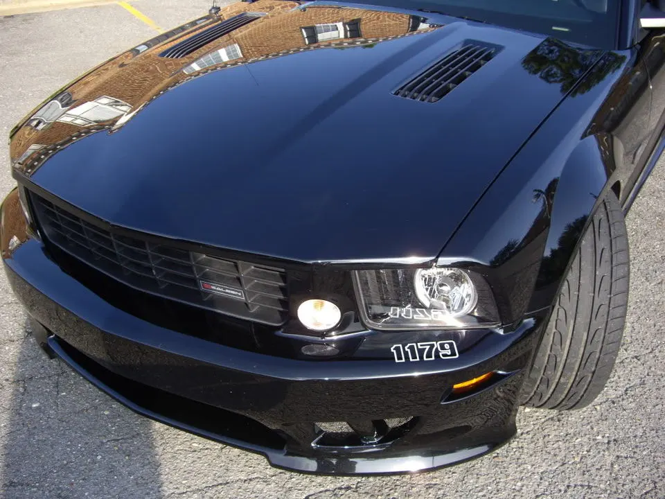

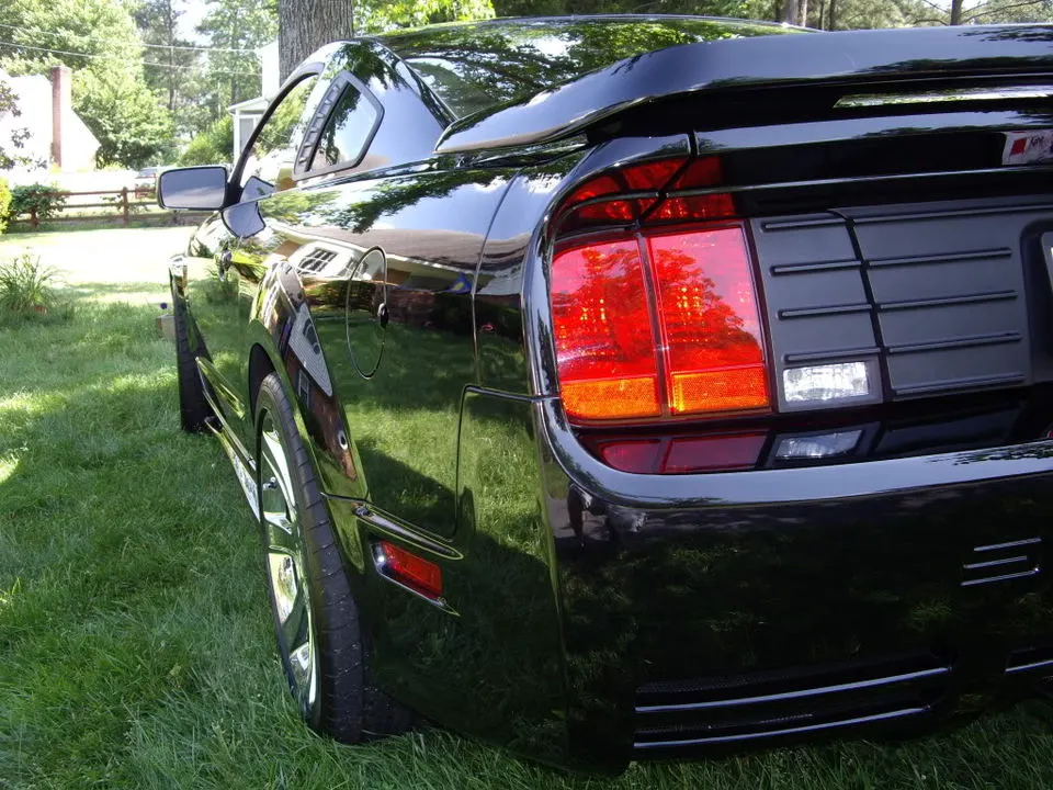

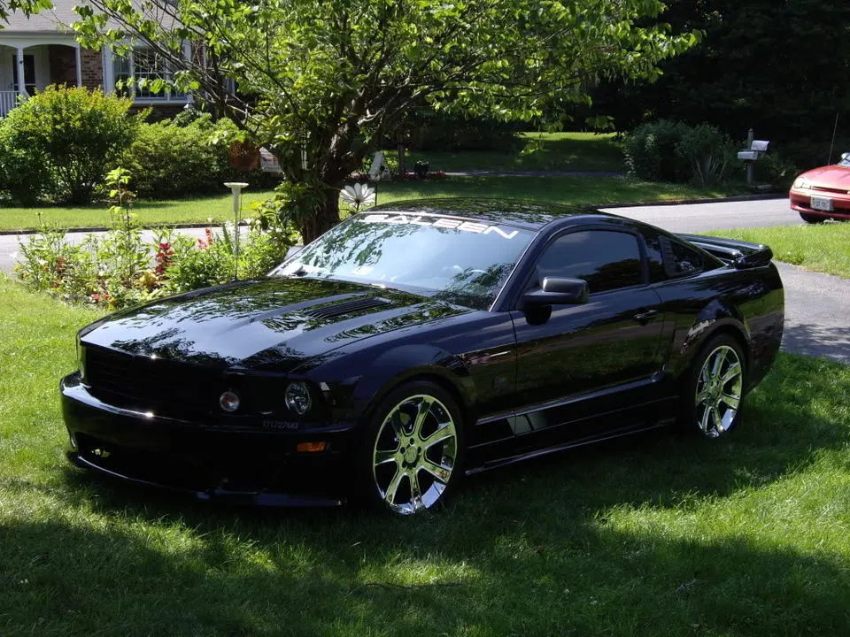

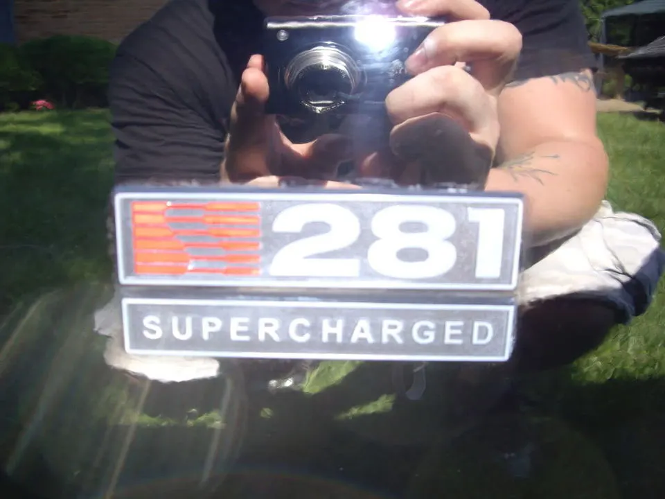

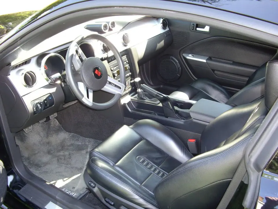

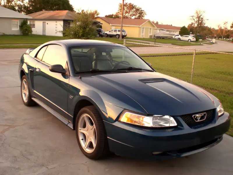

Ok Ok Ok.... Personally I find Zaino to be the best wax... not the best swirl remover... but the BEST wax when it comes to SHINE and Durability.... Meg. are good for over the counter waxes... I happen to swear off any Turtle wax product... its all ****... it doesnt last but about 2 washes... the ice happends to be the worst stuff I have seen used *wouldnt dare use it on my car...* here are some pics with ZAINO products... you be the judge
