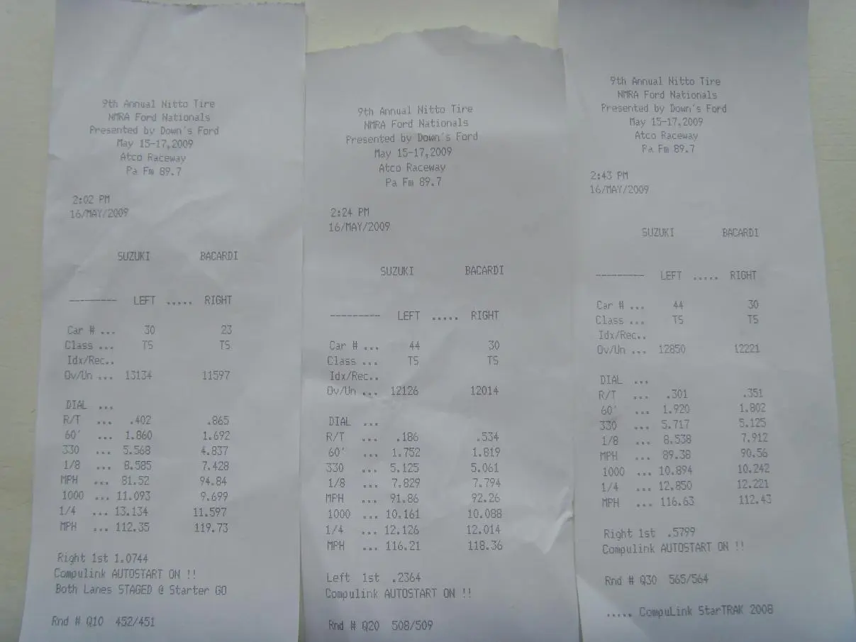

The best run was my 2nd with a 12.014 ET and a 118.36 MPH trap. My goal was to get into the 11's and I just missed it. I added some more Methanol injection which could have hurt the performance some. I'm going to drop to a smaller SC pulley and remove the spare and jack and I should be there. Car #30 on the attached timeslips. BTW the car with me weight in at 3192.
I'm babying my car with a let out the clutch and floor the gas and then granny shifts. The 1st race I had 25 psi in the Micky T's and I spun in 1st throught 2nd and then in 3rd. I dropped them down to 18 psi on the 2nd run and they hooked. The 3rd run I dropped them down to 15 psi and once again they hooked, but I heard noise and I let up off the gas and I got back on it. The car seem fine and rode fine on the way home. I just need more practice at it at test and tune nights. It tough to race a manual transmission cars.
