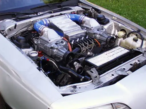

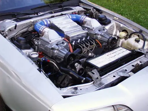

A few people have been there and done that.....but it didn't work as well as planned. Don't get me wrong, it made power, but it was more of a gimmic than anything.
Two superchargers add twice the drag on the motor. For simplicity, you may see 100hp gain with one supercharger. However, you may only see a 150hp gain when using two superchargers. It it MUCH more efficient to use twin turbos.
I've read somewhere at full boost, a supercharger robs almost 100hp from the engine just to pressurize the air. However, the same turbo setup only uses 10hp, thus, explaining why a Turbo can make much more HP with the same boost level over a supercharger.
:cheers:
