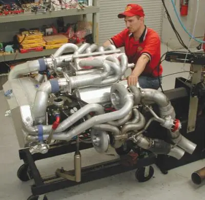

pssssh... real men use 4 turbos. hahahaha
Hey!!! I remeber that kit! I had one in my Toyota Celica lift back when I was in highschool!
