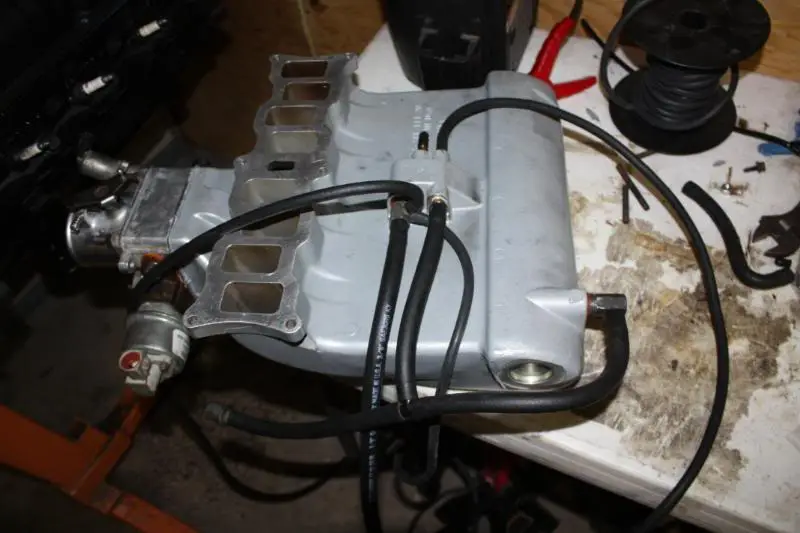

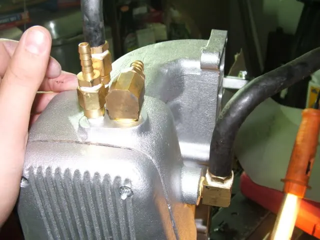

ok here is a pic of what i have. the one on the bottom with the hose and the one that is facing away came with the intake. the smaller 2 i had installed. so my delima is how would i hook up the 2 for the PCV valve which IIRC used 2 - 3/8 barbs. which would take up the only 2 - 3/8 barbs i have. but i still have the line that goes to the vacuum tree. and if i hook up the 2 3/8 lines to the PCV then i would have to hook it to a 1/4 barb. but that 1/4 barb is really coming off of 1/8 port. which i don't think would be enough to feed the whole vac tree. and then i have the EVAP which would be the other 1/4 barb, which is no porblem. HELP.

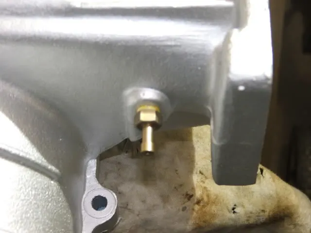

there is also this small fitting that is for the FPR
