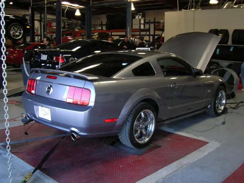

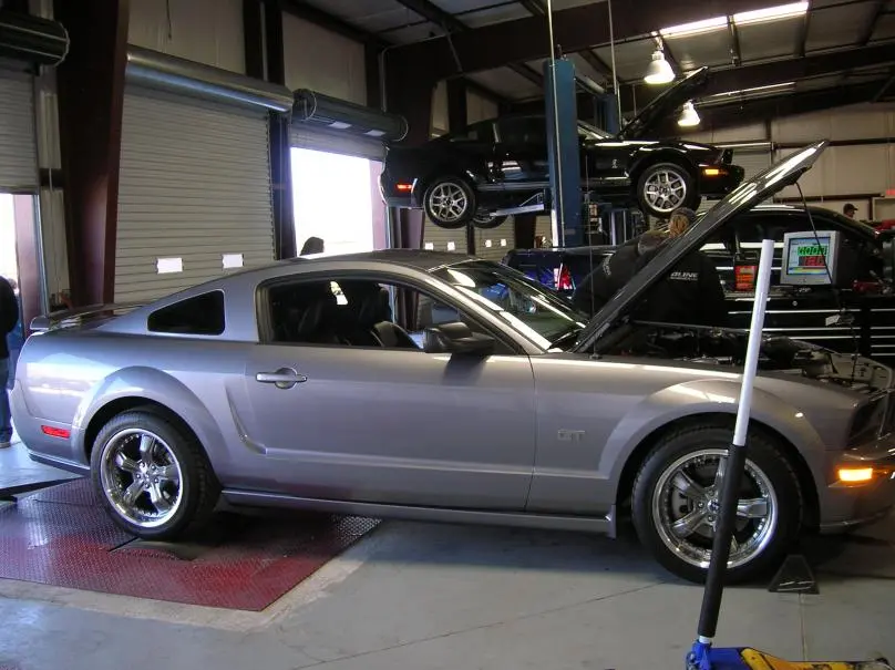

Did you come to Georgia to buy that car? That is my old mustang I traded in at Cobb County Toyota, I told them to give the buyer my phone number if they had any questions. In the trunk was a set of flomaster axle backs, 4.30 gears new in box and the X-cal2 with 2 custom tunes from MPH. Tim tuned it last Feb and it made 290rwhp and 308rwtq. It had a JLT Cold Air Kit, Pypes off-road H-pipe, GTA mufflers and the Shelby Wheels had only 900 miles on them. I broke both of my feet and had to trade my car in. The car was mint and had NO PROBLEMS, they gave me $20,000 trade in value June 2008. Congrats on the purchase take care of her, I washed and waxed her twice a week the entire time I had it. Let me know if you have any questions.
Nick

I'm pissed that they didn't give you my number and all the parts, I'm anal about things and I wanted the new owner to know the full history behind their purchase, hell I even gave them the dyno print out. If you ever need any help or mod advise give me a yell, I also have a extra dyno sheet if you would like it just pm me your address and I'll mail it out. When you get back to town look me up and I'll take you out for a beer! Thanks for your service to our county. Here are some pics of her on the dyno.
