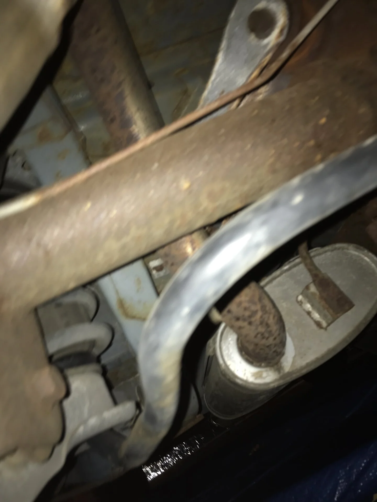

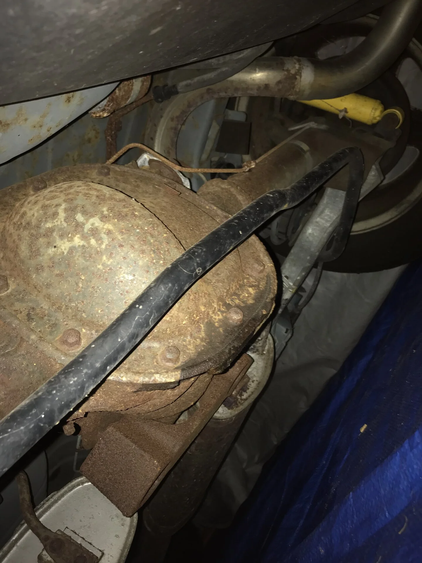

Hello. New guy here. I have the opportunity to acquire an 89 Mustang LX 5.0 Convertible that has been owned by various family members for the last 25+ years. The car is basically all stock and in good condition with around 120k miles. There isn't any visible rust on the exterior, or the shock towers, but there is some surface rust underneath the car. The floor pans look ok. The car hasn't seen winter for the last 15 years, but it was driven through a few winters around 20 years ago. My question is: will the surface rust that is present now continue to get worse and worse and eventually cause structural issues, or is this not a big concern? Is there anything I can do now to minimize the rust damage from spreading? Here are a few pics underneath the rear of the car:
You can wire wheel all of the surface rust on the floor pan and then paint it... As long as you find no surprises..
Some items, like the rear end housing would be easier to do if you removed it to clean and paint it.....
I figure this is not your daily driver so this is what I would do, I would pull engine/trans, rear end, then as suggested by limp, wire wheel the rust spots, this will give you the opportunity to check, replace brake/fuel lines that are suspect, and looking at that fuel filter you may need to, yes this means dropping the fuel tank, working your way forward inspecting shock towers, and frame rails, using something like Por15 to seal it up as you go. Cleaning, sealing up the bottom of this car will help preserve it.

I see you're from Ohio. Judging by the pics, that almost looks as clean as a California car! 120k on a 33 year old Mustang is virtually low mileage. The second pic however, gives me pause. The fuel lines/filter and brake lines are about what I'd expect from an Ohio car. Replacement is in your future. If it were me, I'd follow the General's plan exactly as stated!
In your first picture, just left of center is a yellow stripe and on the right of it looks like gasket flaking, or flaking rust?? What is that....
That's about what my 87 looked like underneath before I sanded and wire wheeled the undercarriage and the brake and fuel lines. Personally I would not replace lines unless they are structurally deficient. Some light surface rust on the outside isn't a big deal. You could go look at a 5yr old car and they'd look like that (steel lines). I didnt remove the rear to paint it, but you can as general suggested.
I started from the front and worked my way back until I had everything prepped, then I painted using rustoleum semi gloss black. I did install MM full length subframe connectors first though.
I did sand and inspect my lines real good though and would have replaced them if any were questionable, but all of mine were fine.

the suspension and axle stuff Knock the heavy rust off with a wire wheel while its off the car then neutralize the rust, clean and prep for any decent paint, I would buy a girdle vs wasting time on the 8.8 cover though.

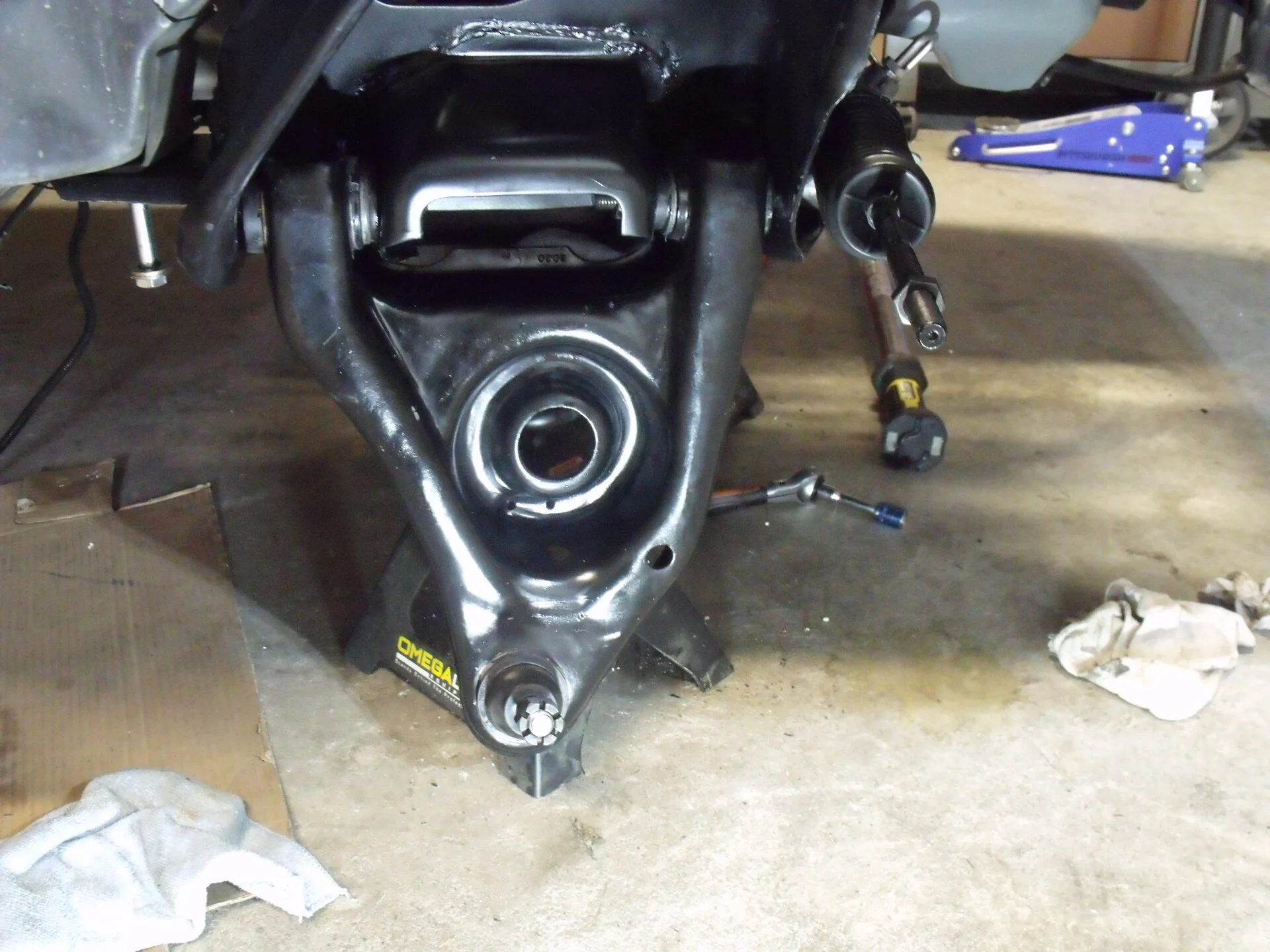

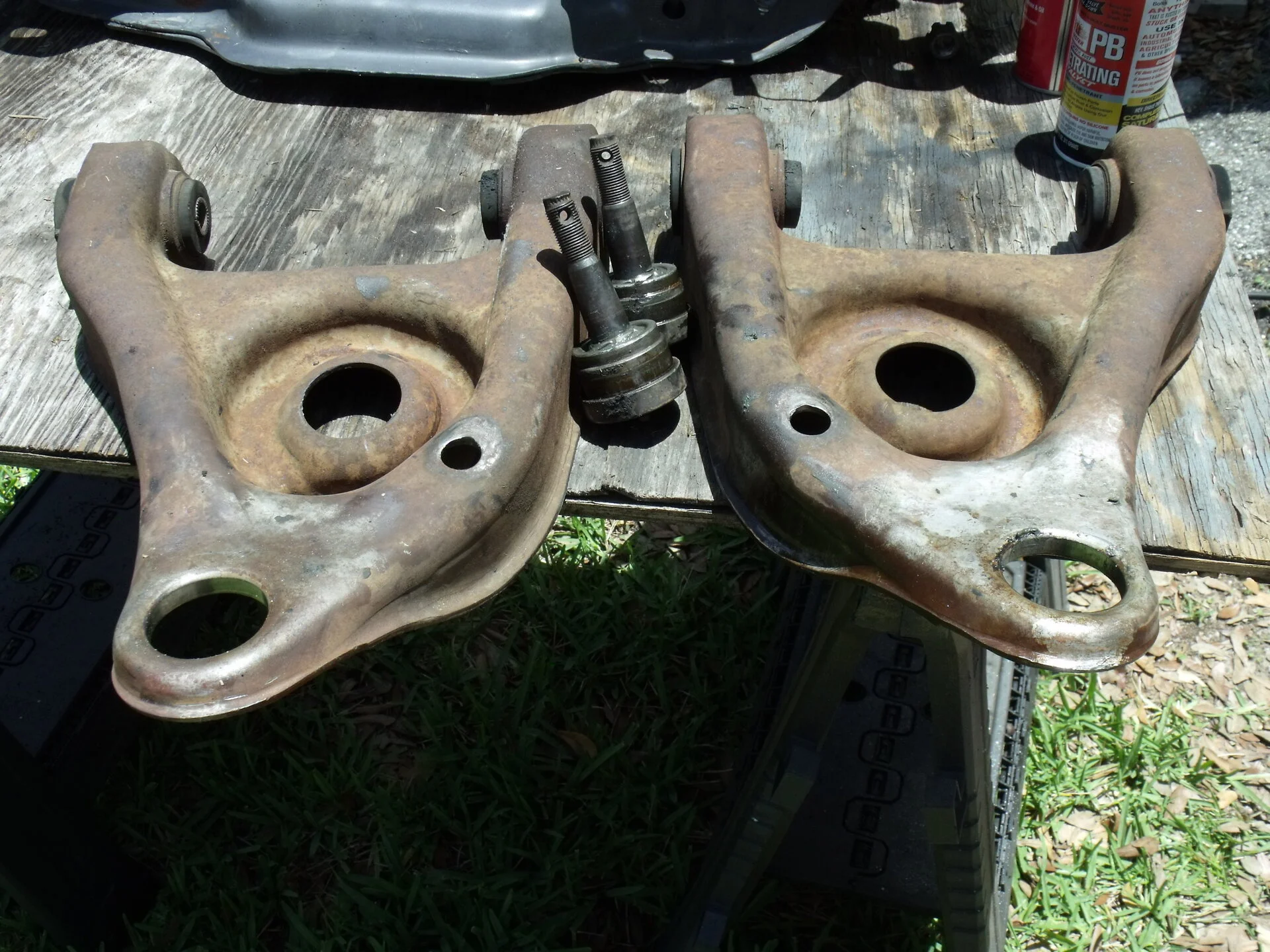

I bought two gallons of Muriatic Acid ( its used for swimming pools) at depot for $11.... I would not have believed how well it literally removes all the rust if I had not seen it for my self...... I bought it for my lower front control arm after spending two days wire wheeling one of them.......
I now use it for all sorts of small parts...... It is water soluble...... Wear safety glasses and a mask around it.....
