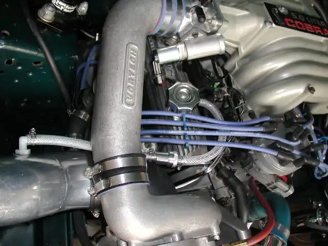

saved this shot of Groverdills car:

Ok so.....i have a turbo not a S/C (doubt that matters tho?).Anyways i run a hose just like the pic of grover dills car but do i ALSO run the stock PCV in the lower intake to the upper intake like it was from the factory?And also is this set up being talked about better then running the hoses off the VC and into a catch can with filter?peace

And one more thing...if doing like groverdill did?Do i need to run that hose into the air intake from both VC or just the one?I'm really confussed cause i see 99% of guys run the catch can with a turbo or S/C set up.peace

John,
The only reason to run the hose in groverdills pic is for emissions concerns.
IMHO, eliminate the possibility of introducing oil into the intake tract... and just run breathers/catch can.
jason
