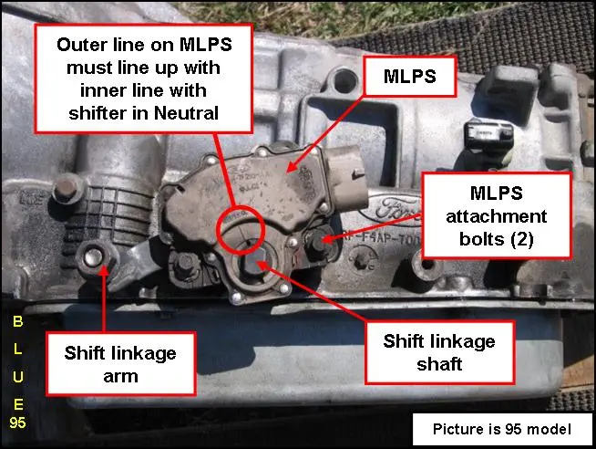

If you have time later,do a little reading up on the Manual lever position sensor (MLPS) if it it acts up,a lot of bad stuff can happen
Here’s what it looks like,and a good look at how it should be set-
