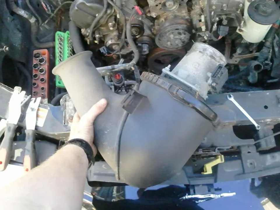

Any one have a picture of the Air Silencer cone?
Same as the one i took out of my 95 Sable? almost looks like a velocity stack?

This is a pic of a Terminator airbox but yours will be similar. The silencer is the flexible rubber bit on the plastic airbox and it extends into the fenderwell. It can be prised out easily from the airbox housing.

So am I holding the silencer in the picture?
Yes.
