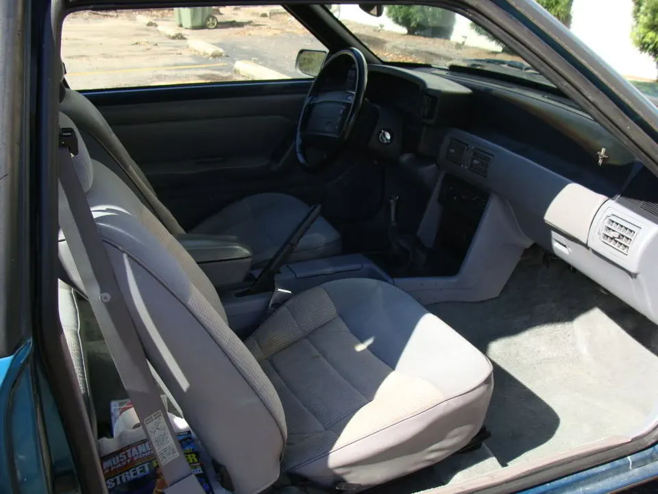

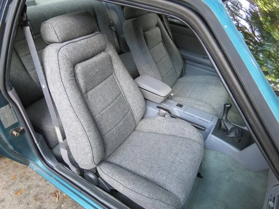

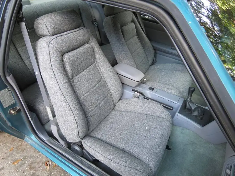

I have done a swap like this. I took my standard LX seats and upholstered them with 1983 foams and customer upholstery from TMI and was very satisfied.
Went from this:
To this:

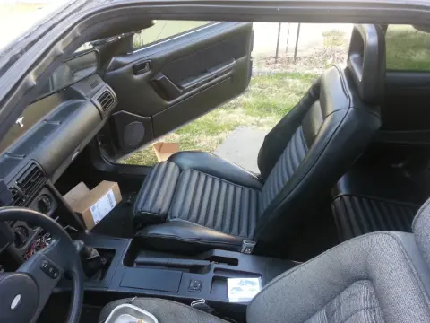

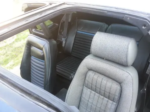

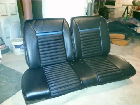

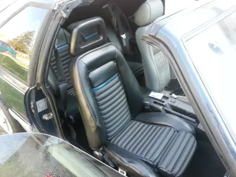

I ordered the tmi mach 1 seats for my 88 t top and i absolutely love them.
I ordered from CJ pony parts and i'm glad i did. They were cheaper and they offered more color options than anybody else. I even emailed LRS and they told me that they only come with the red stripe and no other color and they cant be customized or modified.
But i get on CJ"S site and they offer three diff colors right on there site!!!! Which i was really glad because my cars blue and would look really stupid with red stripes in my seats! lol
It took about 35 days for them to get them too me because they make the upholstery as you order it so there is a small wait time. BUT IT IS WORTH IT BIGTIME!!!
I installed the covers myself and had no fitment issues or quality issues at all. There are no instructions include with them but you can find write ups on the net if you do a google search.
I think i paid $450.00 and that was for the full set for my hatch, with the large headrests which i didnt use because i put halo headrests in them because i never really liked the big headrests.
If anybody has any questions just message me and iwill be glad to help any way i can:nice:

Yeah those look great and I don't even have an issue with the price. But this all depends on one key component. THE FRAMES. Which for most of us are in terrible shape.
Come on TMI! Make some frames or better yet FULL SEATS. I see MUCH value in that.
And before anybody asks the wrinkles that you see in the seats pretty much went away once there broken in. Also i did not use new foam like they suggest and i just used my old foams so im sure that had a bit to do with it.
My frames were not in the best of shape. The passenger side was OK but the drivers side SUCKED! They weren't bent at all but my drivers side was rusted to hell and back. My car sat for a long time before i got it and had its fair share of rust and mice nests threw the whole interior.
The drivers seat had a saggy bottom and just sucked. Ordered a new seat spring off ebay and looks a lot better now. I still have to finish the drivers bottom yet and put it back together and throw it in the car.
I do realize this doesn't help anybody whos frames are beyond repair though... :cool:
