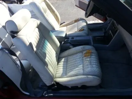

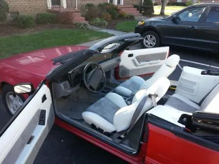

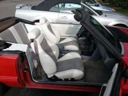

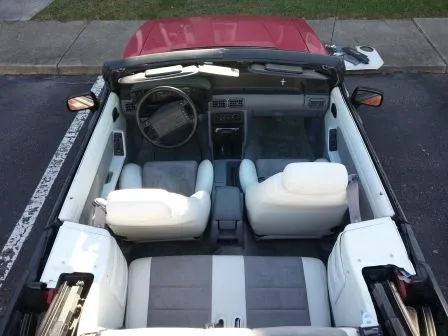

Hey guys, I just had a great experience with the 03-04 Cobra seats in my 93 Vert. Ordered them from TMI but in White w/gray suede inserts. its a custom color, but take a look at the difference.
Managed to do this myself too with some hog ring pliers, a youtube video from LMR and TMI and a weekend. I love the results. What do you think?

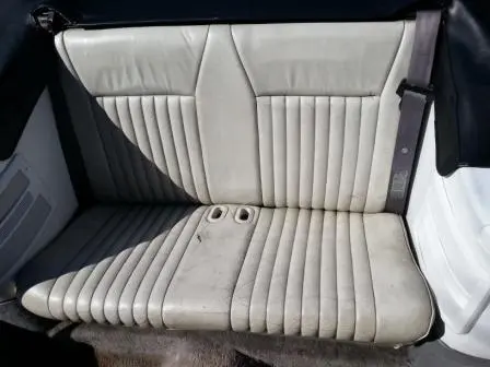

Wow, that turned out great. Nice work.

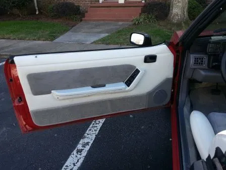

So TMI made the matching door panels for me, and also picked up a pair of sunvisors. Really completes the look I think.
the panels are totally custom, with white vinyl, suede inserts, carpet bottom instead of map pockets in 85-86 light gray to match my carpet, opal gray speaker to match the rest. all for the same price as an off the shelf set. These guys were great. :)
Hey Jpdyno2. How do you like the suede seat/back? Is it staying nice? I was thinking a black red combo for my 89 vert. Similar to what you did....
