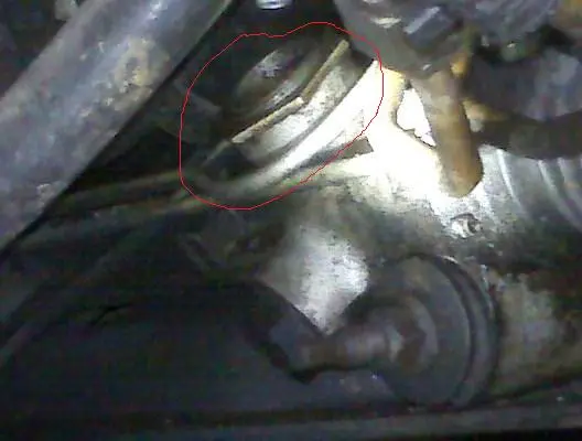

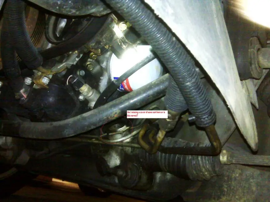

I was doing a routine self check of my 02 GT and I noticed something looked odd in the engine department.
Please see picture (I have it circled).
What is this part and what does it do? When I look from the top, down I can see oil of some sort.
Am I missing something here or is that how it looks?

no your not missing anything. that is the steering gear and what you have circled should look like that. and almost every car as they age will have a little bit of fluid seepage out of that. not a whole lot but a little and is perfectly normal.
Get a can of Gunk engine degreaser, spray down the entire area, wait 15 mins and then hose it off and it will look new.
That area gets filthy from oil changes, and it's common to look like yours. Every time i did an oil change, i'd buy a can of Gunk and degrease the entire underside of the car as well
That is the rack pinion preload adjustment screw. I agree that the oil that you're seeing is probably due to improper cleaning after an oil change. I usually hose down the whole area with brake clean and dry with compressed air when I change a customers oil.
Clean the whole area off, test drive and re-check. No oil should be leaking, no matter the car's age. A slight film or 'seep' in that area would be acceptable, but if there's a drip you have a leak that needs attention.
