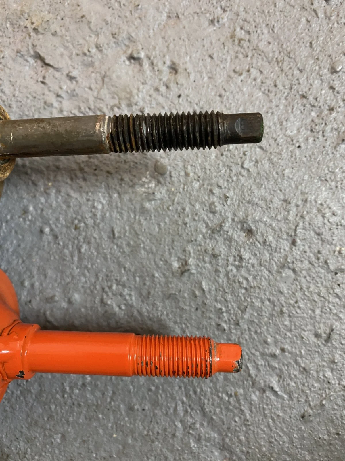

I am attempting an install of Koni STR-T shock/struts on my 01 GT. I have the factory rear shock removed, but it appears I can’t reuse the factory mounting hardware to reinstall the top mount?? The threads don’t match the factory part. I was told these rear shocks reused factory hardware. FYI, I purchased these off Facebook marketplace, so no additional parts were included. I attached a photo of the thread comparison. 57DBD663-8324-4942-83F5-7A34D35CA86A.webp
Just a quick update for those that are interested: I was able to successfully install the rear Konis using hardware from Home Depot (closer than Lowe’s to me). The nut size is an M12-1.25 and I used an M12 lock washer, just in case anyone else runs into a similar problem to mine.
