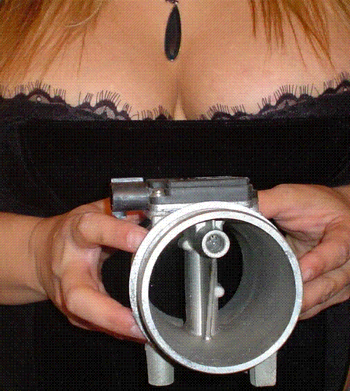

Just to be sure this guy is actually selling a Cobra meter...
The sensor should be marked 'F1SF'
The housing should be 70mm

The housing is 70mm, I will ask about the sensor itself. The tune includes a custom 4 position chip with dyno time AND fuel/timing adjustments. Here is a picture of the item itself...

I don't have firsthand experience with the Cobra unit but over the years I've read way too many threads about bad results with the meter. Personally, if something isn't tested and true I would not put it on my car especially an MAF. From what I've always read, that particular meter was designed to be ran on the 93 Cobra only. Your way better off with the 94/95 meter, I've ran it for years without any issues.
the cobra's meter only flows marginally better than a smaller H.O. meter like the others have stated due to the placement of the sampling tube and backflow inhibitor in the primary inlet tract, which turned out to be a huge design flaw and the ecm was programed or "tuned" by the factory to correct it, later designs went to the sampling fine wire we now see. the problem was the added minimal increase in air flow restriction reduces the voltage signal, causing a unsafe lean condtion to devolp the factory designed or tuned the program to richen the mixture a move to the safe side under most operating conditions in the 93 cobra but running it in a 5.0 with 19lb/hr injectors caused a lean condition under most operating conditions. so a tune would be needed to fix the fuel/air unless you used a complete 93 cobra set up ecm, meter, injectors which ford tuned has package., but w/o the ecm, and injectors the tune would still bring marginal gains due to the limited tunablilty of the cobra meter over stock, the 94-95 meter or aftermarket meters have a better range of adjustablilty in them or less "restriction" in them which nets better results. in most cases if you talk to tuners and probally more so for the newer cars and mabye not our 55 meters but depending on the mods the meters from the factorys support alot of power and an aftermarket meter in most cases is a waste of cash.
If I understand correctly, you would be the same either way, the meters do the same thing and send the same voltage to the ECU. It's all in the way the ECU responds to the voltage. In this case, you would be flowing slightly more air and cause a lean condition b/c the computer would not respond to the additional air correctly b/c it's getting a voltage signal that corresponds to a 55MM volume of air instead of 70MM. If you're getting a dyno tune with it, you'll be fine but it sounds like it will be pointless if the sampling tube in the cobra MAF is as big as what they're saying.
