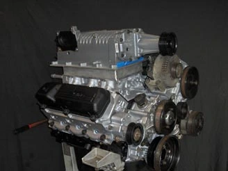

Everyone who's wanted to bolt a M112 S/C on their 3.8, the time has come! Tom at supersixmotorsports.com has come out with an adapter. My engine is currently being finished up at his Georgia shop and I should have it Feb of '08. He's a hell of a nice guy to work with and his work is second to none! Granted some of you may feel that putting an additional 125 hp on a '96 Windstar is nuts but I always raced before breaking my neck 22 years ago when I raced, restored and unfortunately sold my 428 CJ Mach 1's. That was long before the prices went through the roof and a van was more sensible than the car...hind sight!
Check with Tom and look at his web site where you'll find pics of the engines.
Here's a picture of my engine in mock up stage only.
Good luck,
Bruce
