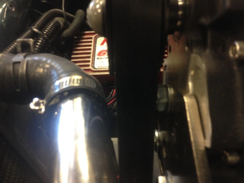

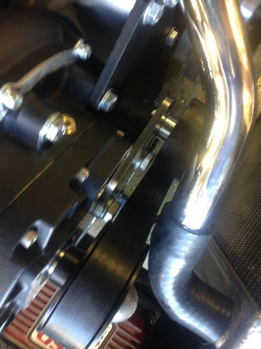

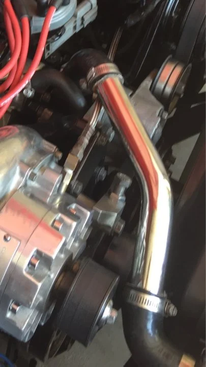

holy tight fit??

I would shorten the hose on the Radiator side to keep it away. Guaranteed it makes contact when the engine torques.
i shortend it as much as i can and cut a bit off the rad also?...think i should go more?...its right up to the nipple?

I personally would shorten more. How long is the stinking rad nipple?

The Hose has to be cut more . Mine is like half of that . And I had to bend the top brackets sung with the rad and cut a piece of old belt to use as a spaced to keep the rad real tight so it wouldn't move to come toward the pulley
I had to do the same things... I will say though your radiator is a different brand than ours and it appears its thicker which will give you these extra clearance issues. I will go out and measure my rad dimensions tonight.

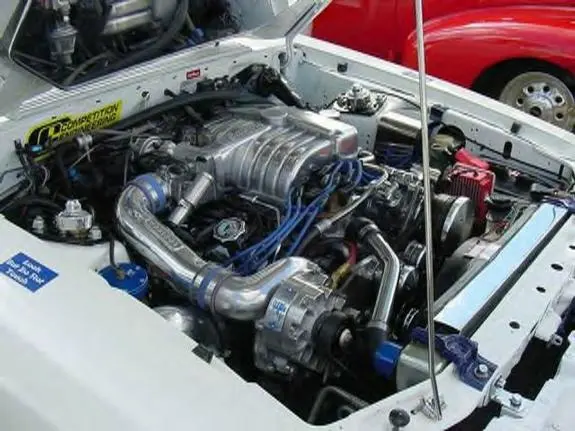

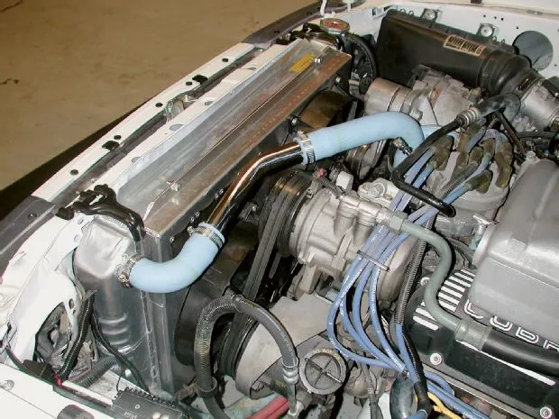

Speaking of this problem, check this out!
From:
M5lp 0502 01 +double Pass Radiator Cooling Fan+radiator Inlet - Photo 31795446 - Chicane Double-Pass Radiator & Cooling Fan System - 5.0 Mustang & Super Fords
If that's the case which I think it is too - take the rad rubbers and slice them to half the thickness with a razor blade allowing it to move forward enough to clear the pulley .

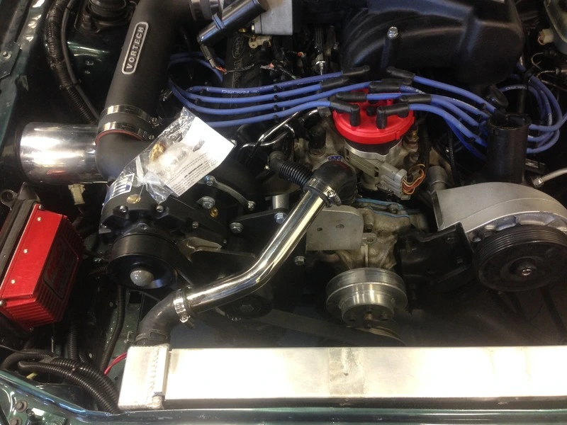

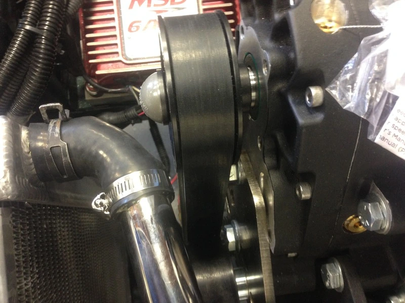

ya maybe it is i dont know....this is the best i can get it and i still dont like it

try rotating the hose on the thermostat towards the driver side of the car. It may pull the hose away from the alt pulley. Also, did you try and push back the top of the radiator a little and tightening up the hold down bracket? I think that is your problem- the radiator is not pushed back enough. I see your end tanks are thicker than the radiator which is pushing it out... can you notch or massage the radiator support a little for clearance?

That's more then enough now . Just make sure you have the rad hold down snug so it can't come back into the pulley and you're golden .

Mine and yours in the last 2 pics now look the same distance I have no issue like that

Mike yours was a 6 rib belt ? where as mine is an 8 I wonder if smoke shows is an 8 as well it's hard to tell

I measured my radiator thickness. My mid section is 2&1/8" thick. My side tanks are thicker, didn't measure those. Maybe this will help for reference.
I agree with TOOLOW91, I'm about the same clearance. No issues.
I had issues with engine torque and fan. Worked with the rad mounts to get it all the way back to frame and what I mentioned earlier about pushing bottom of rad back as far as it will go on rubber support. Then of coarse I really compressed the rubber gasket on fan shroud and tightened the bolts to hold it. No more problems.
ya mines an 8 rib....and the rad is as far back as it goes,from what i can tell thats how they are?.....i looked at your pic toolow91 and tried to make it the same.....thanks for pic by the way,i feel better now!
