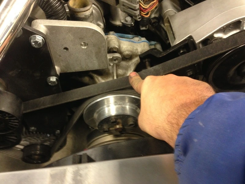

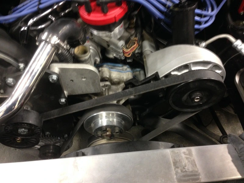

ok well ill find out later about the belt,car is at work and i was just reading that people were having issues with the belt touching the waterpump so im in a bit of a panic,maybe its just with the stock belt size?.....but im going to have to string it and find the right size belt for it and hope things work out,one good thing is i do have a underdrive waterpump pully that might help things

well i need a bigger pulley for sure,thats the tightest belt i can get on there,had to force it on,and tentioner rubs...i loosened the psp and lifted it a bit and it will work....i have a head ache with this now!
is that an underdrive pulley on that water pump? if it is, going to a stock-sized one will give a touch more room too. the 93 cobra one is even smaller, but as mentioned, is really friggin hard to find anymore.

ya it is?.....aren't you supposed to go smaller on the water pump?
edit:smaller ya got ya...
I have another idea if this becomes a pinch . You could re drill the hole in the bracket so the tensioner locks in higher to allow you to run the tighter belt and keep it off the water pump pulley if that makes sense

Underdrive waterpump pulleys are typically larger than the stock pulley. You need to go back to the "smaller" stock pulley or a '93 Cobra pulley on your waterpump.

ya your right,sorry brain fart....i put the bigger power steering pulley on and im almost there....i got a bunch of belts and just about had it with the underdrive pulley,87 1/2 was just a tad tight,but now i put the stock pulley back on,so i think im going to need a 86 1/2 ish belt....i cancelled my dyno also.....gona re-book once i get eveything sorted out....i cant sleep at night need to get her started!...lol
