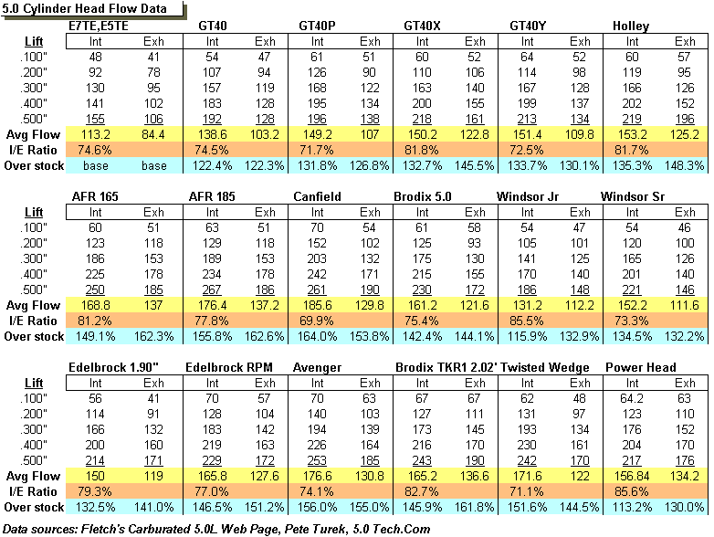

If you are looking to spend a little less money you can run these and they work with stock pistons:
185cc SBF Enforcer Cylinder Head - Stock Piston Small Valve
Cylinder Head Specialists
www.airflowresearch.com
Flow rates on the GT40’s can be seen here:

I’m not boost savvy but maybe Noobz or rednotch would have some cylinder head opinion based on your build if you want to reach out.

Thanks for showing me another option for compatible with stock pistons. However, I’ll stick with the 1472’s for a few reasons.
1. Chamber cc is closer to what I currently have.
2. 1472’s use pedestal mount rockers which is what I have and want to reuse.
3. Deck thickness is far thicker on the 1472’s at .750” compared to .325” on the 1342’s you showed.

Oh, flow rate is better on the 1472’s as well.
