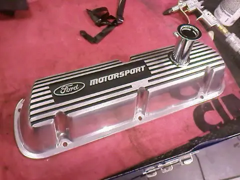

Well i took my vlave covers to work Ultra sonic cleaned them sanded them, zinic primed them a cast type color same as my Intake...But i came up with an idea just passing this out there these are not finished yet still need a few coats of paint then clear...I bought supercharged stickers in red i want to do the top portion on the valve cover in Black bottom left sliver these decals are red online type in the picture the backing is still on but you guys can get the idea so what do you think?....

I cleaned them in a Ultra sonic tank at my work..then i hit them with a die grinder that had a scotch brite pad attached,then primed them with zinc primer..There no Were near done yet im going to sand them with lite sandpaper..use fill and sand primer...then paint them 2-tone sliver and black top with the red supercharger sticker on top of the black..after that i will clear coat over everything then back it in the oven we have at work...its meant for stuff like this..I Think the sticker should hold up but if it doesnt buy that time my budget will be better so i will get chrome valve covers or something nice....:)
Thanks..The only reason i thought to put the sticker on was because its a little plain looking i wanted to spice it up a little...Maybe a different sticker maybe not supercharged?...any other ideas...keep them coming...Thanks...:nice:
