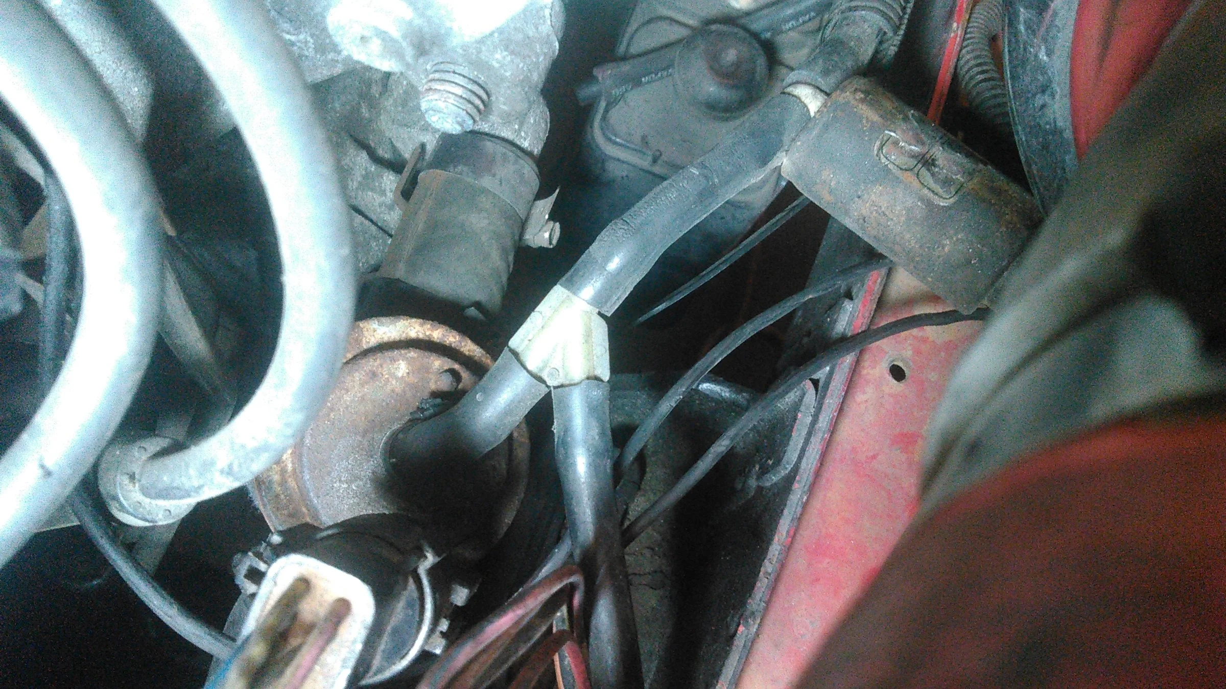

I thought the vacuum line from fuel tank was cut and capped at charcoal canister, it's actually been diverted into the bypass valve along with hose from solenoid with a Y splice. So if solenoid opens, if it works, is doing nothing now. Should it go back through canister? Most of the hoses are dry rotted and cracking, replacing them neater, but they don't follow the diagram.
