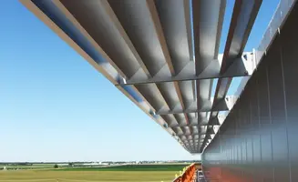

The other part of this are sun shades for the hottest side of the garage.
This way the building is not absorbing all of that energy.
