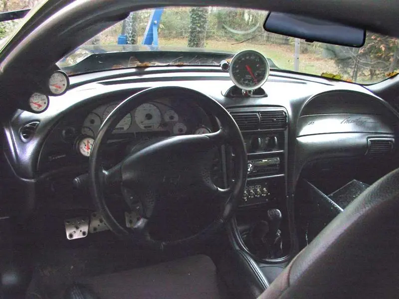

EDIT: also, got any pics of the switch panel? im gonna be making my own for any that have any advise
The pic sucks, but it's the best I have of the switch panel:

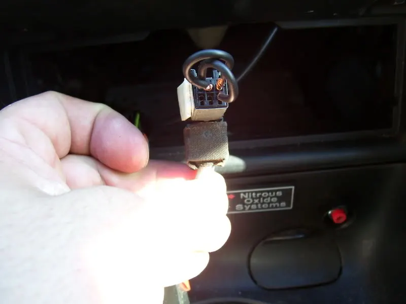

Probably not the best way, but it worked for me...
get back at the plug that went into the cd player, then jump wires till the speakers come back on. I forget which wires need jumped, but you'll have to make a three way jumper. It's not cosmic, just a bit of ingenutiy to find the right wires. If you NEED it, I'll take a picture of what I did.
good luck
ok, i need a little clarification. there are 2 plugs that went into the back of the cd player, one has prob 5 or 6 wires going to it, the other i think has 2. by "jump 3 wires" do you just mean splice 3 together? is there no danger of shorting something and screwing up my whole system if i splice the wrong ones?
trying to upload a photo for you, taking forever though...
in the meantime...the fat gray wire (more like a covering), with the L shaped connector 6 pin plug, is the one you want....make a Y, or 2 into 1 jumper wire. bear with me here...
hold the gray wire in your hand, wire going toward the floor and look at the plug
you'll see the receivers kinda like this
123
456
jump 2 to 3 and 3 to 6
by jumper wire I mean, take a small piece of wire, strip the ends and shove it in the receptacle. (this could be taken way out of context hahaha)
Worked for me,....as far as problems, couldn't tell you what may encounter, who knows?
It's worked for me for a year trouble free, just haven't had time to replace the whole system with a-market stuff.
good luck
thanks hef. works great now. i actually just used 1 wire, put one end in #1 and split the other to go in 3 and 6
well if you did it this way i hope you used a big wire like the ones pictures other wise it will get hot you will have to much resistance running on the undersized wires and your prone to the wires melting and a possible fire
