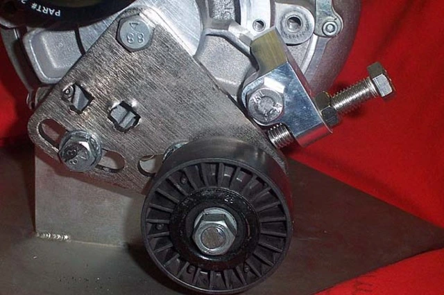

i'd recommend you invest in an adjustable belt tensioner for the supercharger belt. The belt tends to stretch and slip. I bought mine years ago from Anderson.
http://www.andersonfordmotorsport.com/index.php/351-12.-Billet-Adjuster.html
They sell knock offs on Flea Bay, but I am not sure about the quality.
