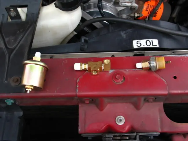

You gonna need 4 fittings from AutoZone ,they cost $8 all together
Like you can see i don't have A/C but i still have A/C bracket so you guys who have one you will be fine

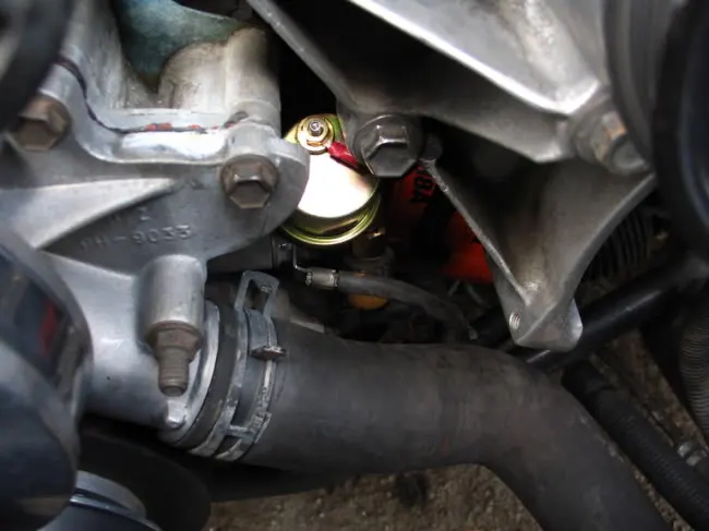

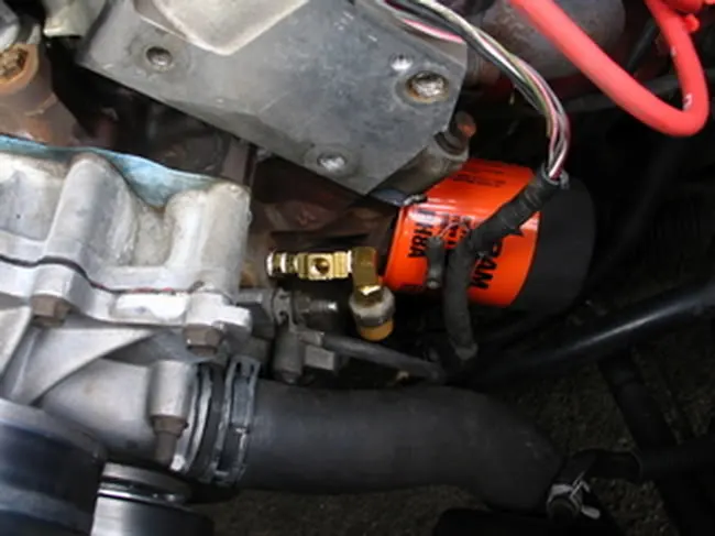

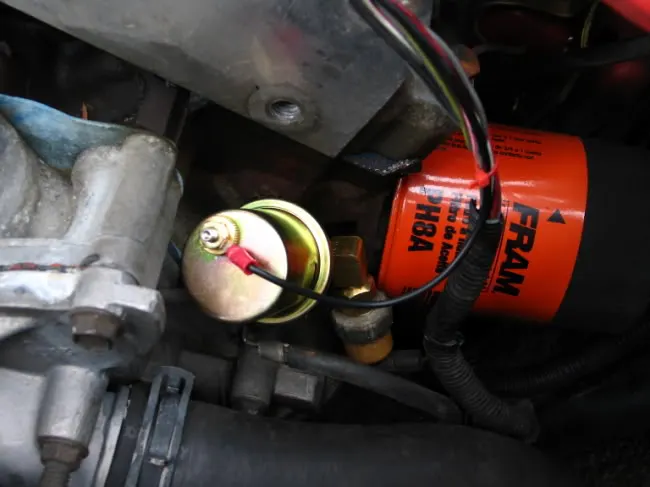

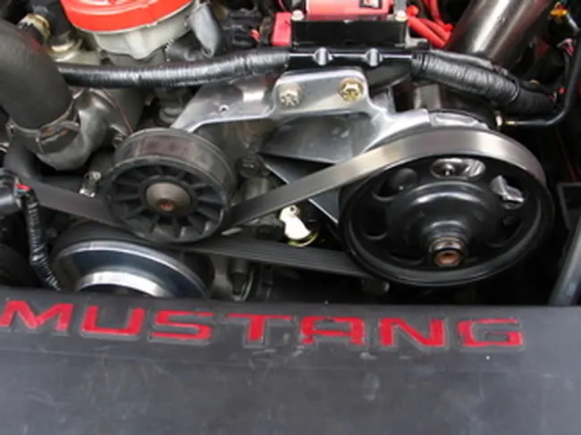

Here is a few pics , i hope this gonna help someone

Nope i didn't get pulley yet, reason why is this pulley bad is because of darn belt , it won't go on easy , but bearing is good

I'm not good with exact names of thosed parts but i have receipt next to me so i gonna tell you part #s and short names from receipt
CP7556 "Oil Pressu" $1.25 (it was on clearance ,real price $4.99) and this is Oil pressure kit , i just use T , that 2" male 1/8 pipe was too long (power steering / A/C bracket was too close)
321132 "Brass Adap" $1.99
321002 "Brass Fema" $1.99
321204 "Pipe Ftng" $1.29
All those 4 parts are bought in AutoZone
You will have to use that 1/8 to 1/4 adapter that comes with AutoMeter gauge because hole on block is 1/4
And you will need to rent in autoZone Power Steering Pulley Puller part # OEM27031 to remove steering pump and then bracket to make installation easyer
I hope this helps , let me know if you need more help , i could go again AutoZone with cam and took pics of each part i use in this little project (Autozone guys know me good because i'm there almost every other day buyin something :rolleyes: )

I tryed BUT thereis little spaceto work, belive me itseasyer to take out A/C power steering andbracket then have BIG time hard time installing OP with those parts in there
Go in AUtoZone and rent power steering puller , its easy
