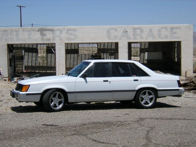

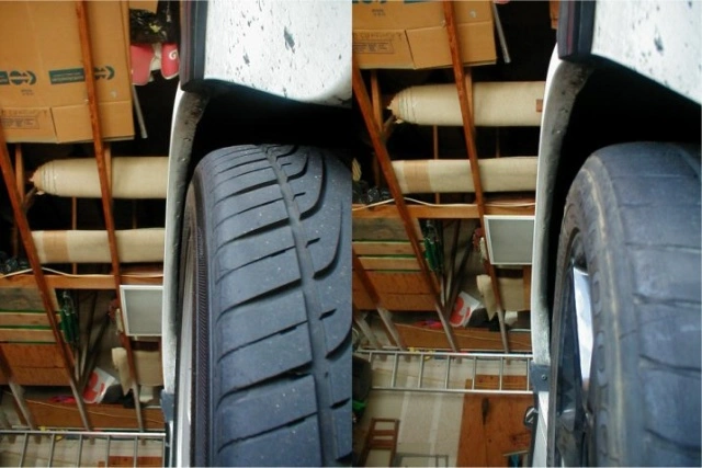

Yup I'll be at Knotts. It's for my LTD (pictured in my avatar). Due to the low slung fender lips, my wheels have to tuck inside the wheel wells much more than a Mustang.
The 99 Cobra wheels fit okay but the tires rub more than I care for. So it's either step down a tire size (which I don't want to do) or find wheels with more positive offset.
I used to have a set of cheapie Eagle wheels (right) which had like a +38 offset and they fit well, so I think the +45 offset of the 05 Stang wheels would be a great fit, plus I love the look of the Bullitts.
