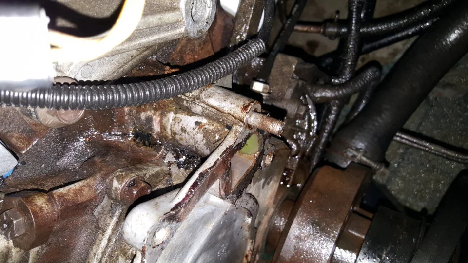

Seems like I can't catch a break lately. Changing water pump and bolt head snapped off. Have half inch or so sticking out but vice just strips bolt and it's not long enough for stud remover to work. If i take timing cover off it will be long enough but trying to avoid removing cover. Will water pump leak with one missing bolt? Just head snapped off. No grinder or torch to use so any suggestions will help.

No tools like that. No grinder or welder. Ended up taking risk and putting back on with a lot of sealant around broken bolt. This is basically my daily driver. Hope it works. But thanks for all suggestions wish me luck lol
Much luck with that. If it holds go ahead and plan on ordering the arp set and replacing these ASAP. it will leak sooner rather than later.
grind a slot in the head of the bolt and see if you can turn it with a screwdriver. A big plus is to buy a cheap propane torch and heat up the area where the bolt goes into the water pump. The alum will expand faster than the steel bolt- spray some PB blaster in there when you remove the flame. repeat that a few times and then see if you can remove the bolt.
