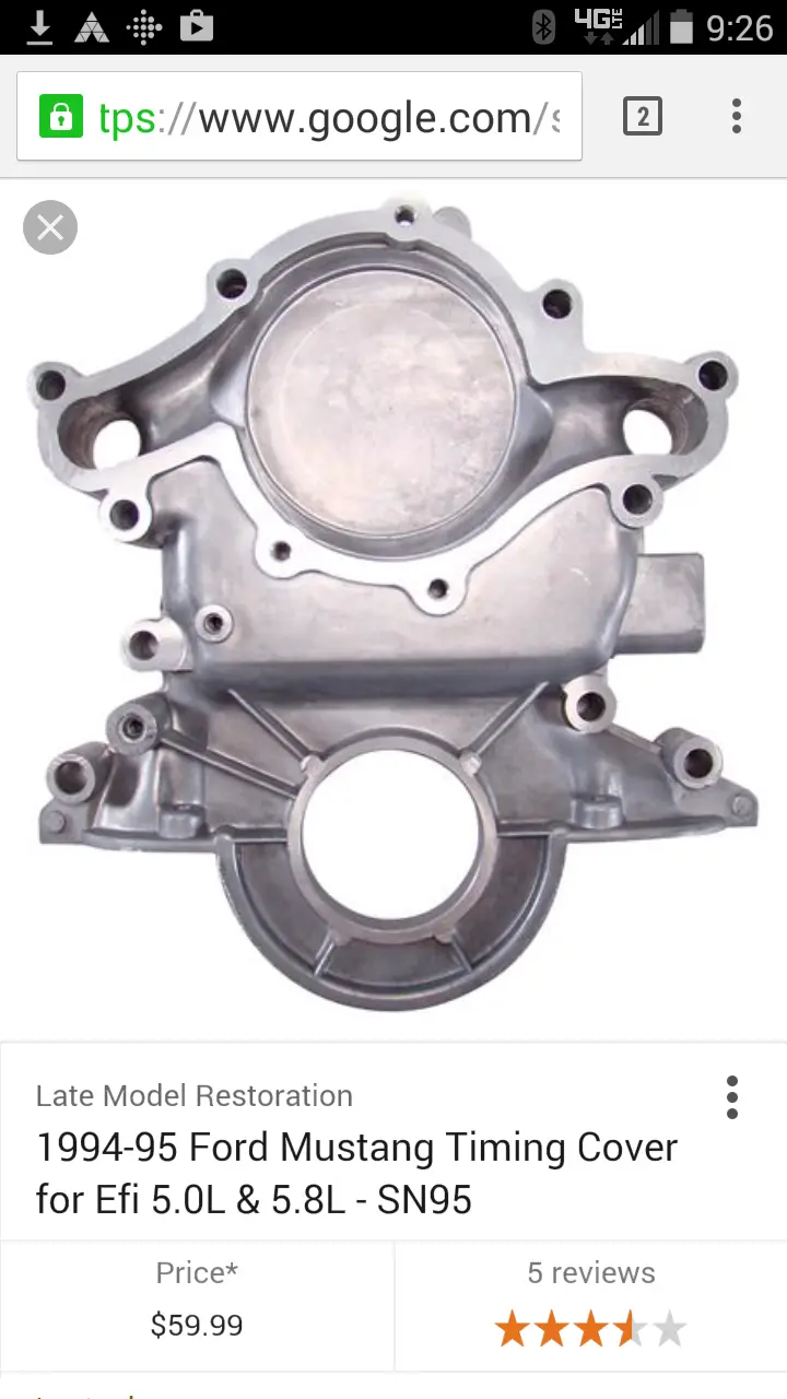

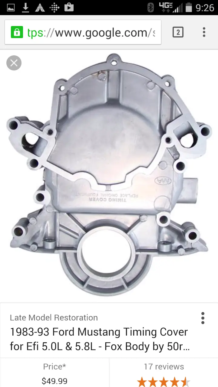

The bolt holes in the block are the same, the 94-95 pump itself may have bolt bosses higher or lower than the 86-93 pump. That and the 94-94 accessory mount bracket is different which means that the bolts have a different sequence of studs, long bolts and short bolts.
The timing covers are different for 94-95.
I also think there's a difference between the lengths of the water pump shafts. Not 100 percent sure...:thinking:
If anything the 95 water pump is shorter...and they do make spacers for the water pump pulley to space it out for belt alignment. The correct way would be to change the timing cover to the 83-93 and install appropriate pump...if not done already.

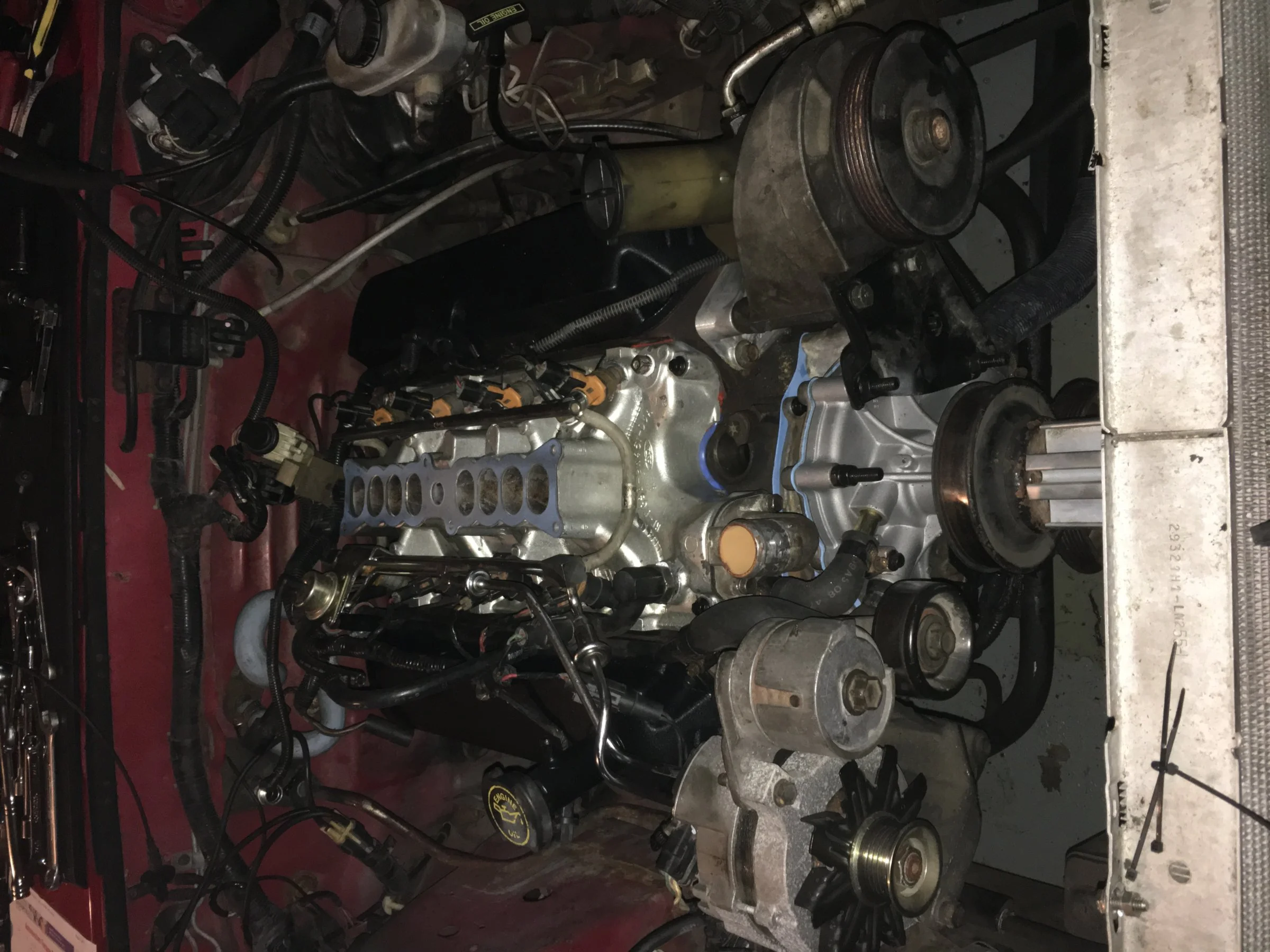

Just a small update. Figured out the lower manifold gasket was causing a massive coolant leak. Ripped the top of the engine off and started from scratch with every gasket and bolt. All bolts replaced are ARP and got the best gaskets I could find for everything. Along with all of this I got the correct coolant tube, and replaced the entire EFI harness because of broken connectors.
Car also had an out of balance harmonic balancer and the wrong dipstick tube. Many of the lower intake bolts as well as the timing cover/water pump bolts were loosened to the point that I spun a few out by hand.
