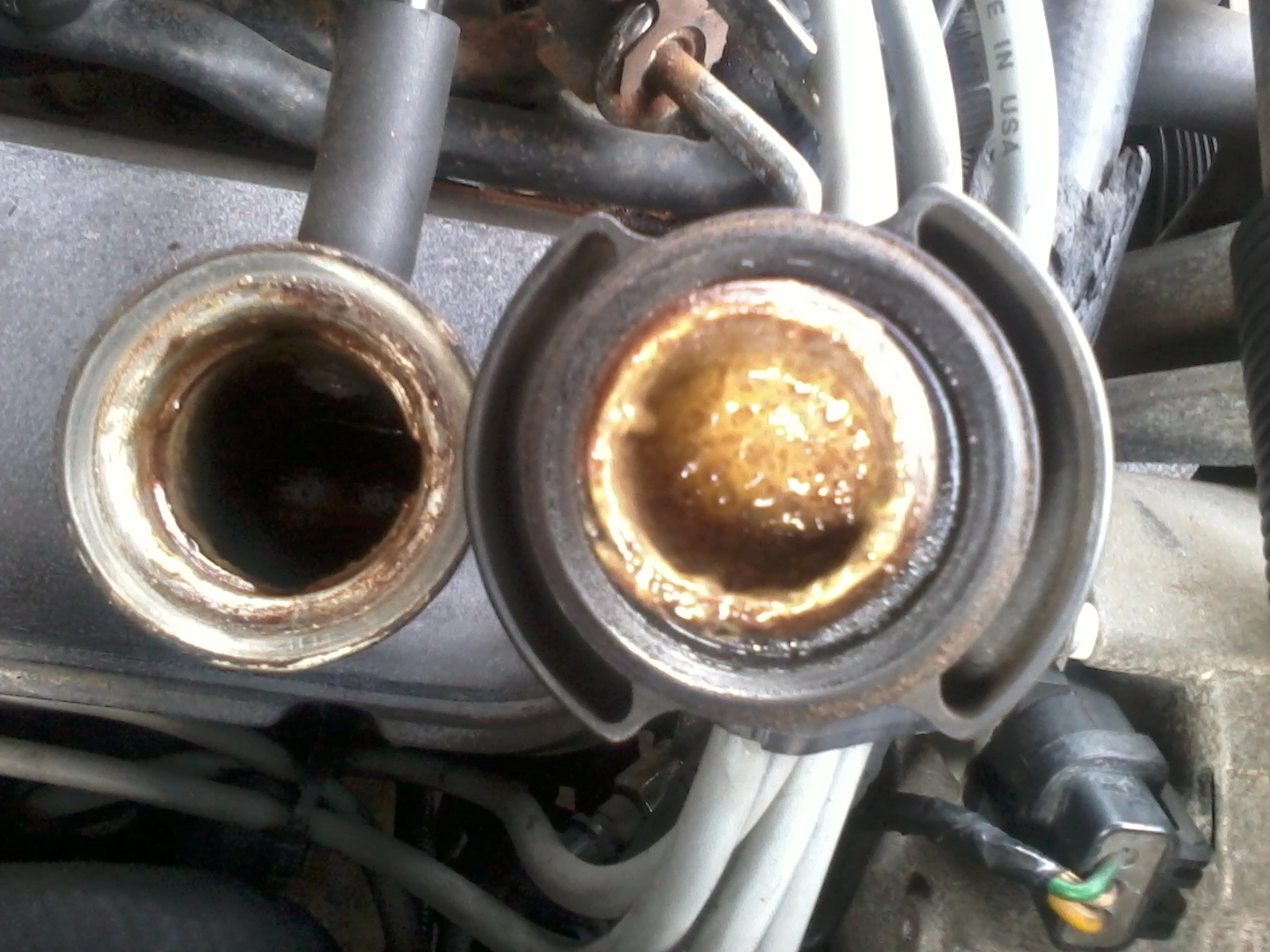

Boo, I gotta tear it all down again. Water in oil. Don't buy cheap gaskets, or rely on RTV. At least now I know I won't be messin with broken studs.

Did your fix go wrong or did you find it after fixing it?

Found it after putting everything back together. I did the job at my buddies house, that is 90 miles away from where I live, and after driving back home, I pulled the dipstick and there was just a small drop of the "coffee" looking water/oil mix at the very bottom. So I am assuming that I have a small water leak right in between the timing cover, and the block. I am ordering a set of fel-pro gaskets to redo it.

Finished the second tear down and rebuild yesterday afternoon, going to do a much needed oil change this afternoon, and I plan on just using some cheap oil for more or less than a flush, and then change it again in about 100-150 miles to work any residual water out. Does this sound good, or do any of you guys have any other suggestions?

Thats what I would do. New oil and filter, make sure ya drain both plugs, run it a little while. I wouldn't do but about 10-20 miles and dump it. Get it hot and then let it drain for a good while with the plugs out. I doubt 100-150 would hurt it either. Most will evaporate.

Thanks gearheadboy, that is kinda what I noticed today. One thing that I also noticed that makes me feel a lot better is that I barely got any water out of the rear sump, so I don't think the oil pump pickup was really picking up much water at all. The front sump was flooded with water, but I think most of that was from the last tear down. Oil looked relatively clean, and O'Reilly's has a hell of a deal on conventional oil right now! Just to be safe, I am planning on running her for about a week, week and a half, then do another oil change. I am planning on going over to my buddies shop the weekend after next to put an off road h-pipe on, which is 90 miles away from me, so I am just going to monitor it until then, if I still see traces of water in the fresh oil, I will change it before that drive, but if it still looks healthy then I plan on doing the next change over there. Thanks for everyones help!!!!!!

Water and oil seperate homie just because it came out of the front dosent mean it diddnt get sucked up the pump. . Look how bad that oil on the cap was. At a maximum I woulda drove 20 miles and changed the oil.

I've done 2 changes sense the initial, and I am sure that it is all clean now. I am still just praying that my main/rod bearings didn't get damaged from this little incident. No knocks yet!! *knocks on wood*
