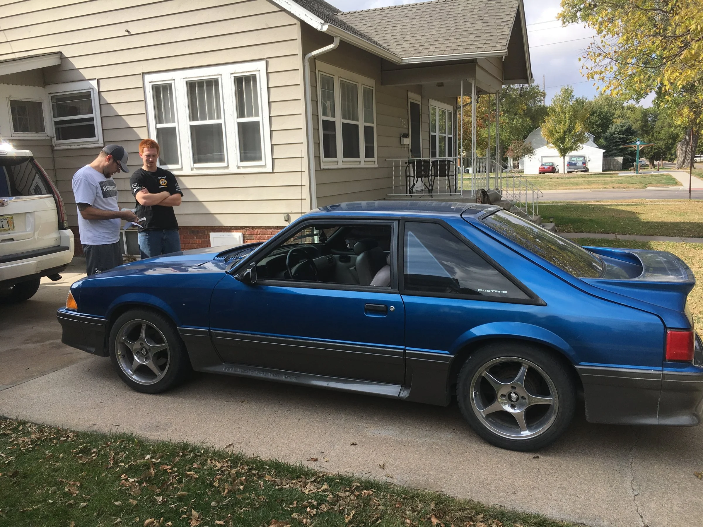

Here is at leats a pic of the money pit! haha
Looks like a clean fox, make sure you soak the bolts (timing cover and water pump) the night before with pb blaster and label them.
Also with budget minded enthusiast, and broke kid maintenance (bare with me a second).
Sign up for advance auto speed perks and use the code TRT41 when shopping online.
Why online?
You can order your parts online and pick up to your local stores within 30 minutes and that code will give a $40 off a $100 purchase. I abuse the crap out of that code for (parts, rtv, pb blaster, and brake cleaner). Keep the cheddar in your wallet my friend

Heads up on the water pump(like Black1987 stated) soak those bolts for at least 12-24 hours before trying to loosen them. They have a tendency to snap.

Sure hope you got the car for a good price. I hate deceitful sellers. My favorite color though! Good looking blue. Put a wanted engine on our classified site. One of the forum members may have a nice motor , fair price for you.

Nice look'n money pit though.
