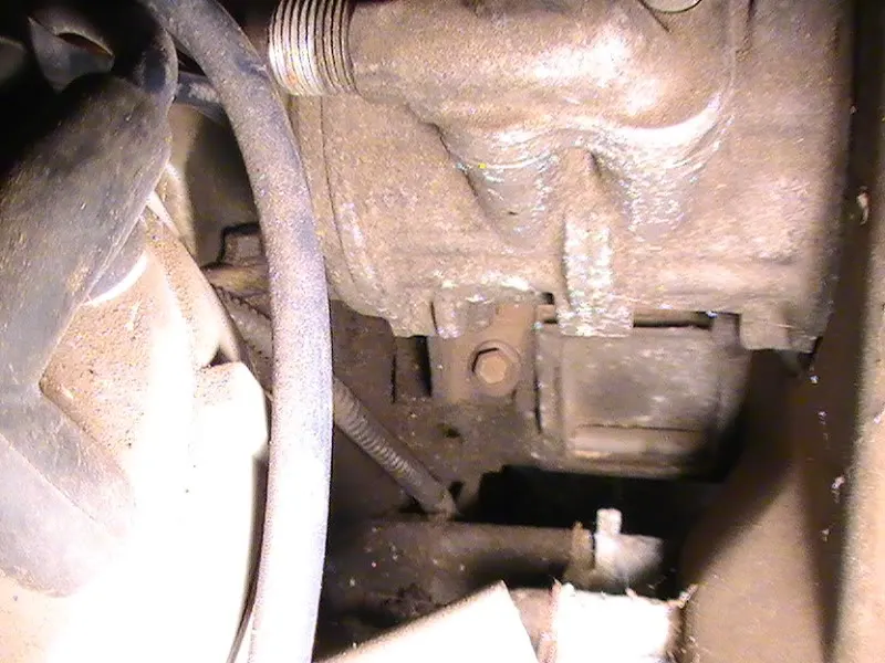

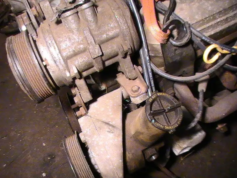

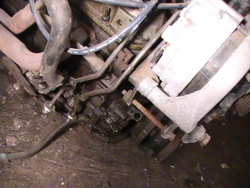

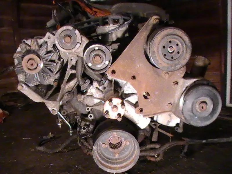

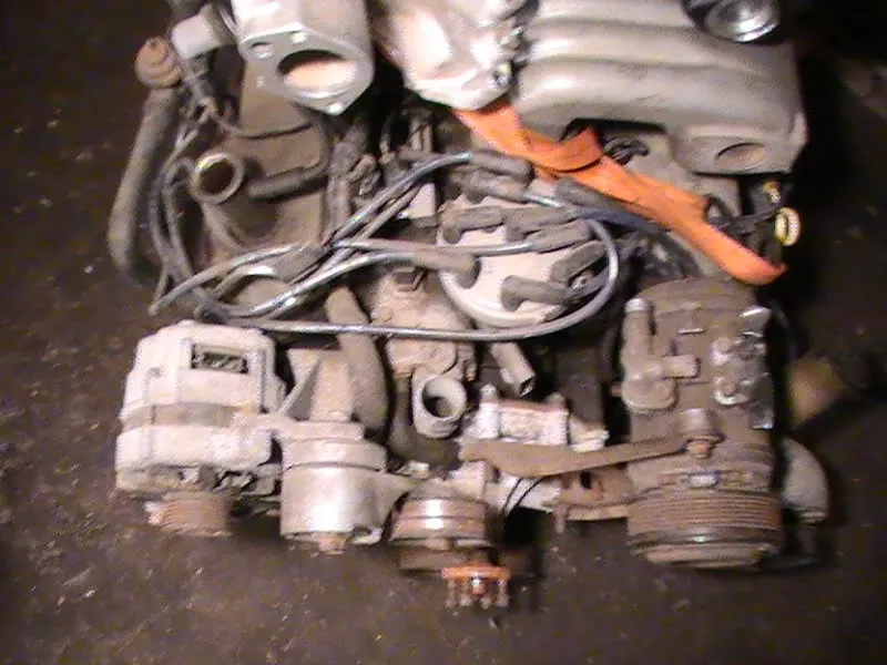

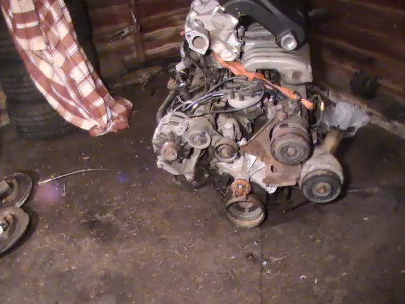

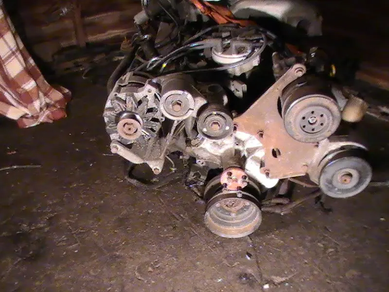

I need a photo or better yet an exploded view of the front engine for the water pump, on a 5.0 with the Factory A/C installed. I'm reinstalling my A/C for this summer and I have no idea where these studded water pump bolts go. I need to have them for the a/c-P/S bracket, but I'm at a loss. Any help would be great! All I need to know is where these bolts go, and I'm on my way to having Cold Air blowing through my vents come monday afternoon!
I hope these help
