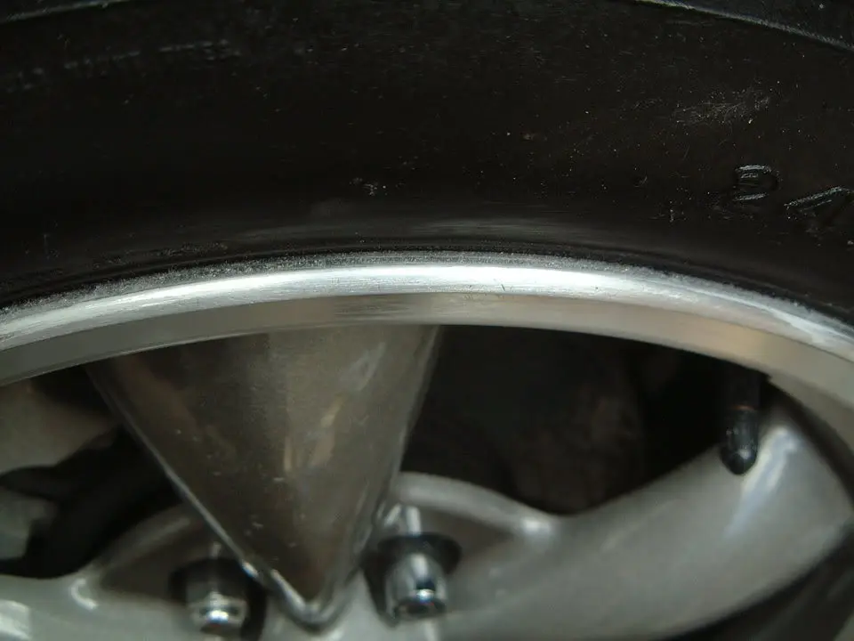

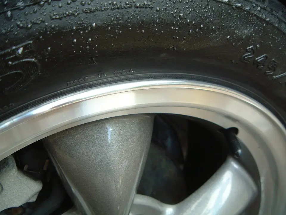

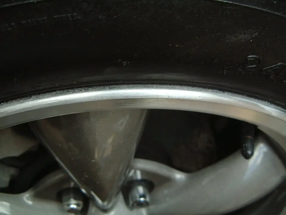

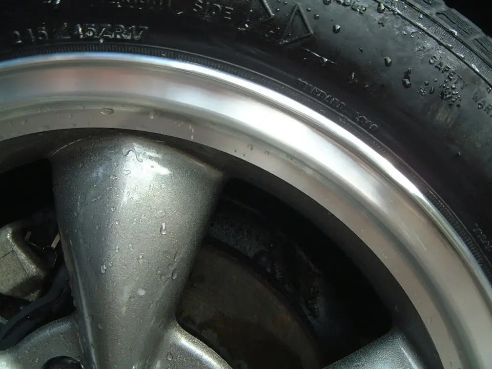

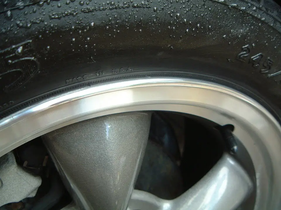

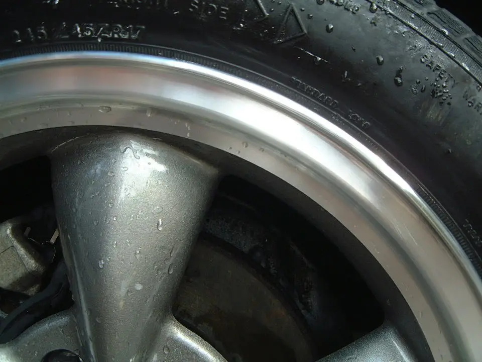

This is an old scratch the rim had when I bought the car
BEFORE

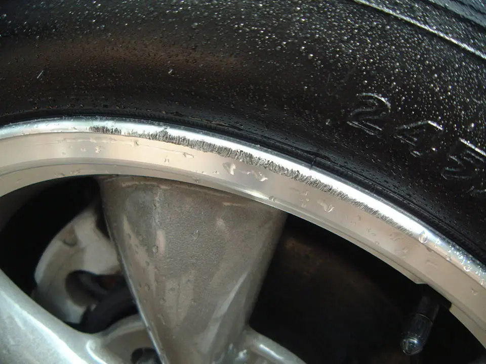

SANDING

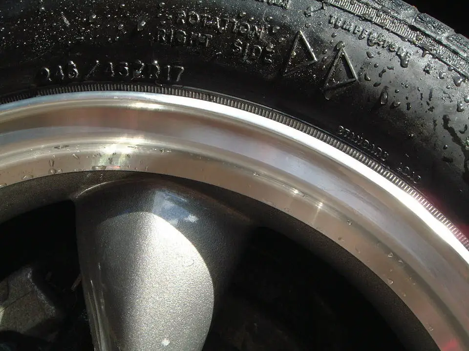

AFTER

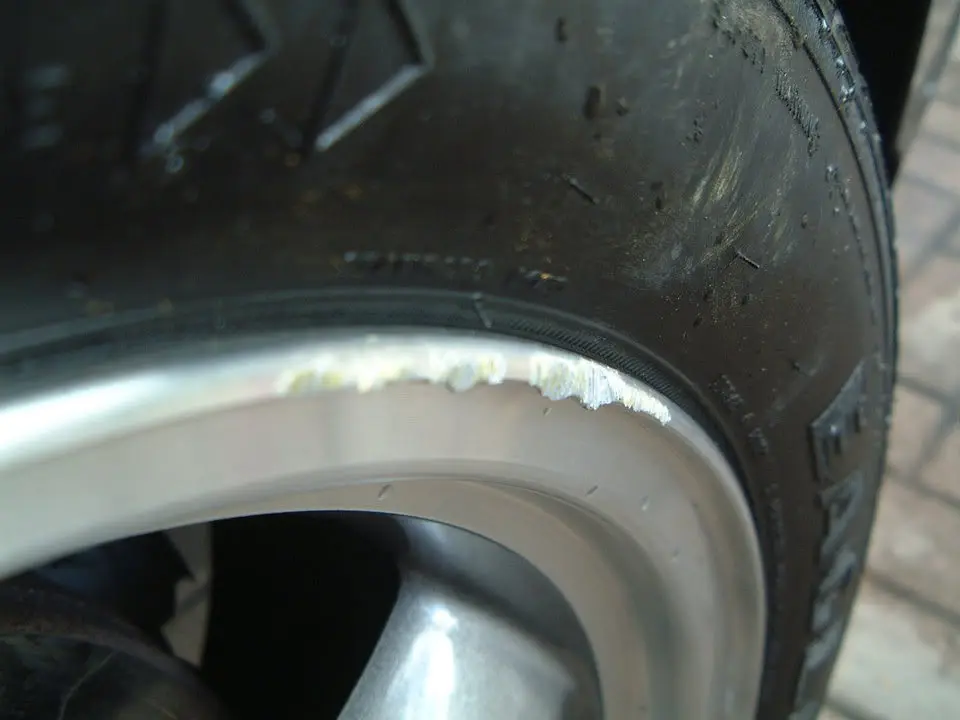

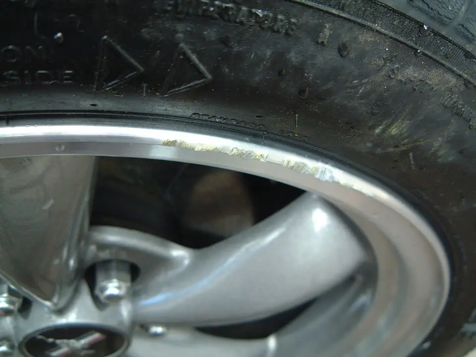

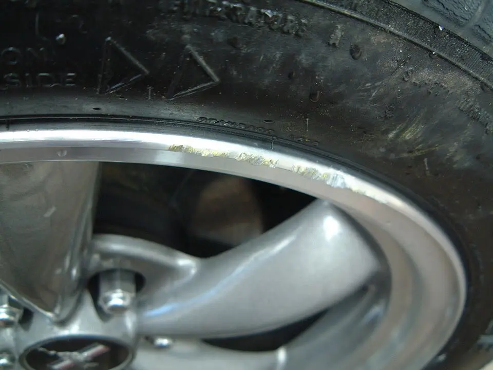

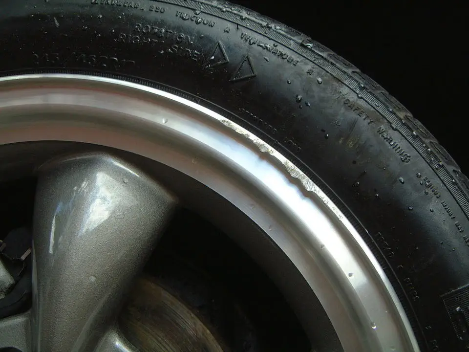

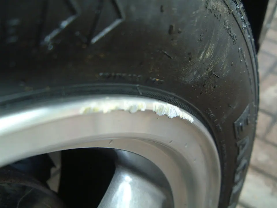

That scratch was no biggy, but this one, this is the one I just made last night. As you can see, I hit it pretty hard :bang: even though I was going idle speed.
BEFORE

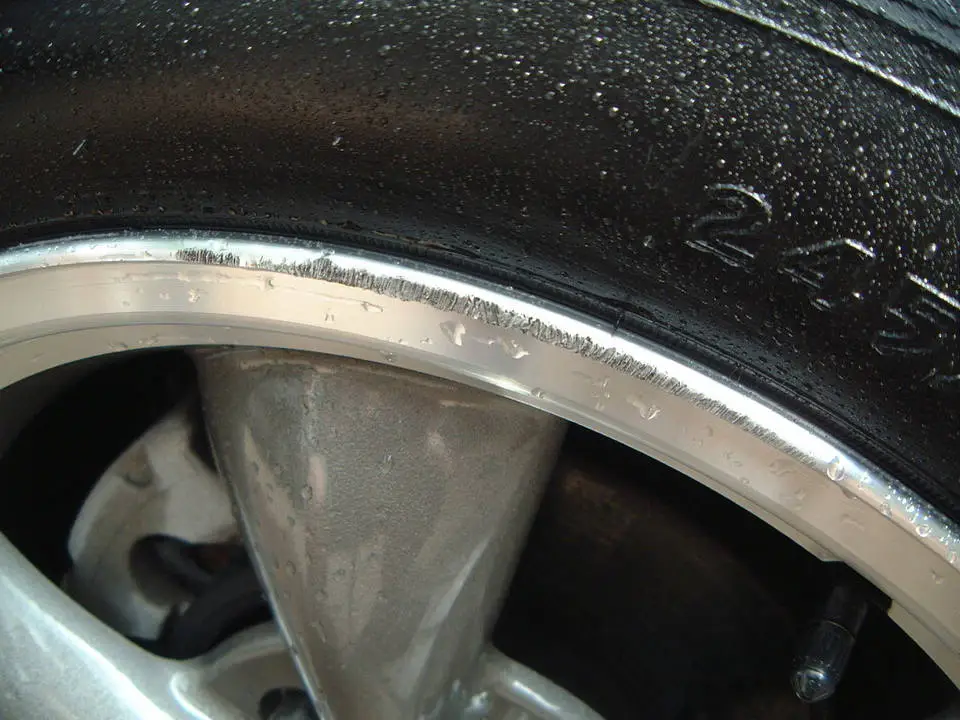

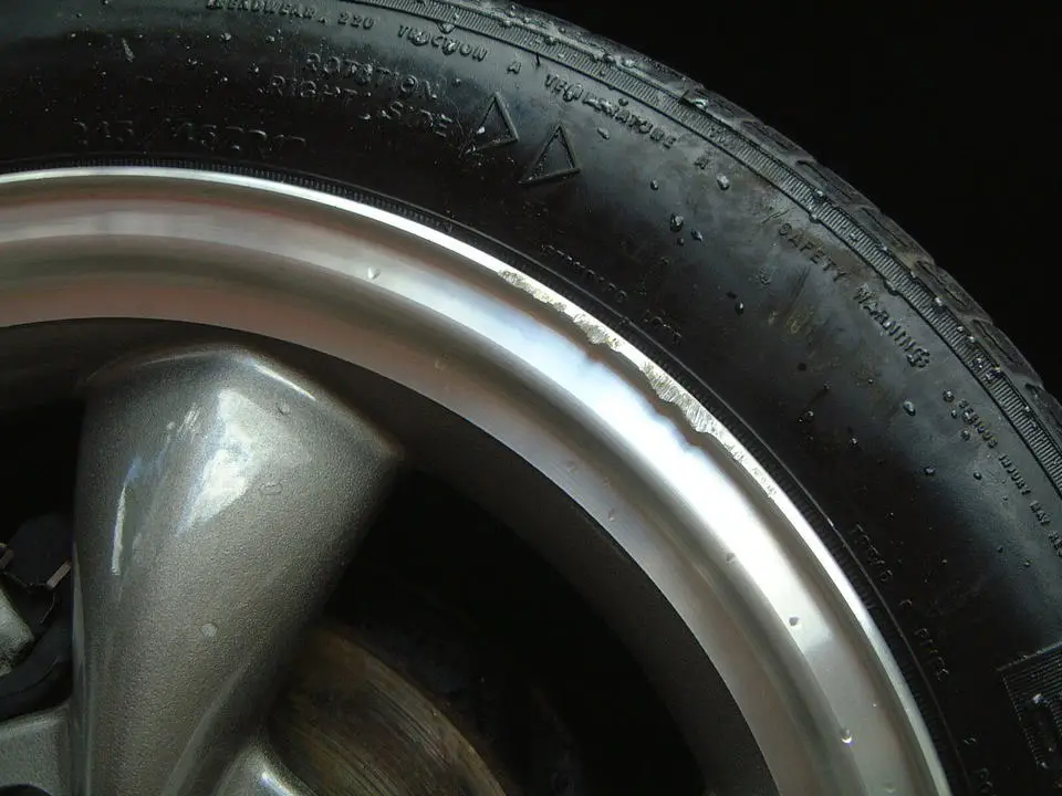

SANDING

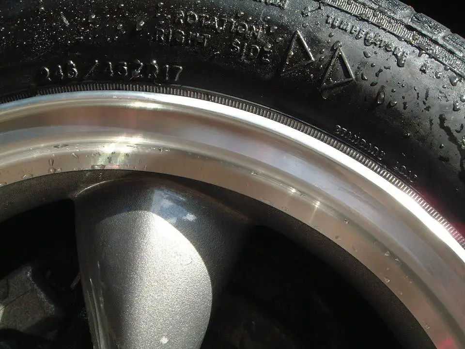

AFTER
Pretty happy with results. I've never done this before but it came out great. :banana:
Only costed 7$ CAD for sanding paper but if you know a bodyshop, you can steal it from them :p
First, I used 80 grit sandpaper and sanded the area down until it's smooth with no pits and no scratches. The surface will be rough but it's normal. Thenn I continued sanding to blend the damaged area with the rest of the rim.
After, I used 180 just to polish the area.
Last, I wetsanded the area using 2000 grit sandpaper. Then I washed the rim, use rim polish to polish out the area and voila!
Pretty easy and much cheaper than to get it fixed at a shop or to buy a new rim.
